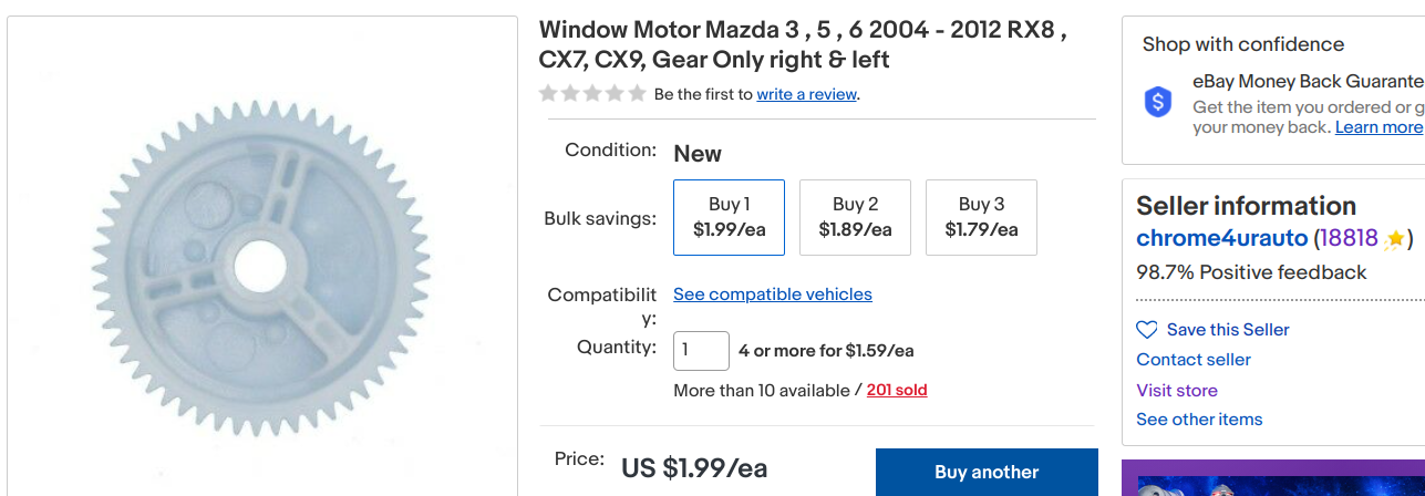

I have a 2012. Two of the windows were not working when I bought it. The front driver side would go partway up and then stop but I can still hear the window motor running. I could help it along by pulling the window up and then it would close all the way up.
It was a broken gear inside the window motor - a $2 part from ebay.
Then you can watch vids from youtube on how to remove the door panel, and another video for Mazda window gear replacement.
