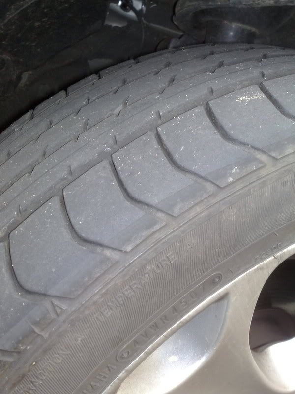

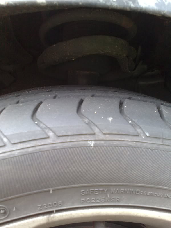

Hi Nick - thanks for the reply.
The sticker inside the drivers door pillar says 33psi front for normal & 35psi fully laden.
Mine were 33 till a couple of weeks ago but I upped them to 35 before we went on holiday in it (full). They are still 35psi (cold).
Checked the tread and is as follows at 4800 miles of mixed driving:
NSF: 1cm from outer edge - 2mm, 1cm from inner edge - 2mm, Centre - 7mm
OSF: 1cm from outer edge - Just under 3mm, 1cm from inner edge - 2.5mm, Centre - 6.5mm
Obviously I would expect the NSF to wear more because of roundabouts etc.
From my login you can probably guess,my own car isan Subaru Impreza WRX and this doesnt wear its tyresany morequickly.
I attach some pics to try and show the wear better: -
What to you think ??
Cheers
Darren
Cheers
Darren

Those pictures look spot on, the tyre wear is about right
