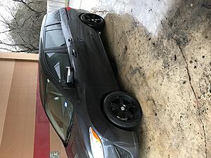

Have a 2013 Mazda five just put 18 inch rims with 225/45/18 size tires.
they rub when I make turns and they will rub if I hit a pothole . Should I go smaller size wheel or smaller size tire what will work
Attached Thumbnails Tire size and rims-4d72cf2f-fded-416e-aa11-ed3fd89f3a59.jpeg

Assuming your wheels have the correct offset (45mm to 50mm), you should be running 215/45 R18 tires. The tires you're running are both slightly wider and slightly larger in diameter. If the offset on your wheels is incorrect, then all bets are off.
