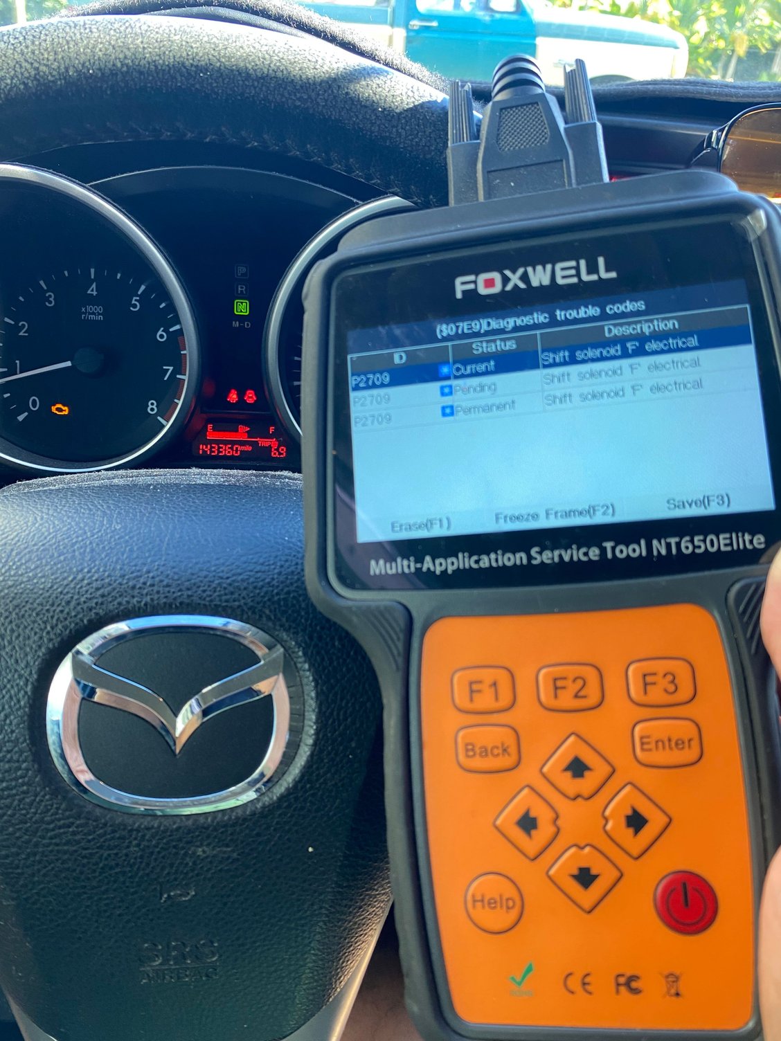

New guy here, and my automatic transmission started acting up and I scanned a code “P2709 shift solenoid F”.
So I tried searching for it’s location online but had no direct results. I found solenoids A,B,C,D and E but not F.
Anyone here had similar problem and found an answer for this?
I have a 2014 Mazda 5, 2.5liter automatic with 143k miles

It’s in the valve body assemble by dropping the pan and filter.
If the transmission has not been serviced at 50k and then repeated at 100k miles you likely have extreme build up on the Valve body and other controllers and areas inside the transmission . So don’t be surprised how bad it looks when you drop the pan. Hopefully u can do a Hail Mary attempt to clean things up by first checking the the and pan magnet.

I purchased the vehicle at 77k miles and changed the trans oil & filter three times now at 143,xxx.
I’ll pick up a new valve body gasket, try clean things up and post my results. 🤙
