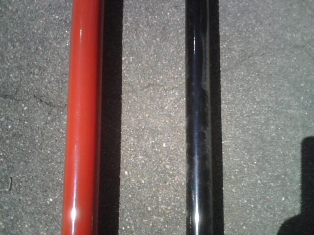

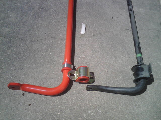

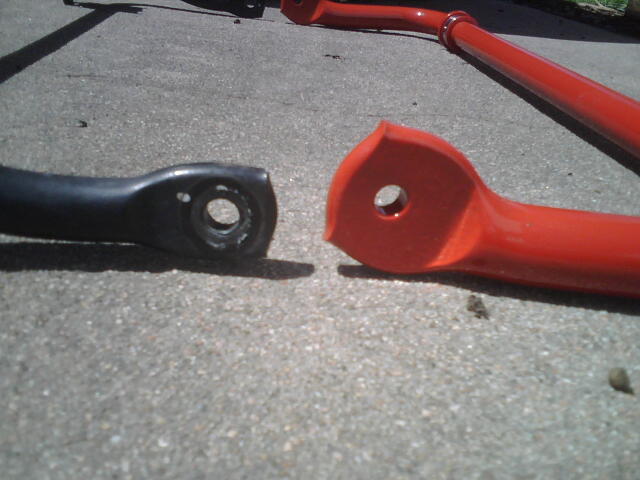

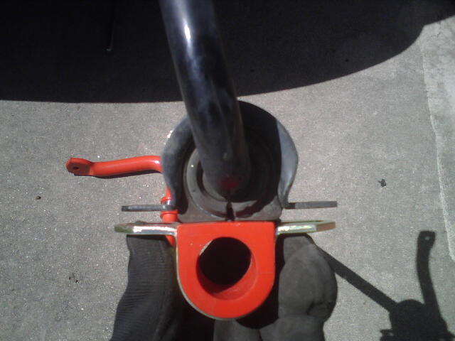

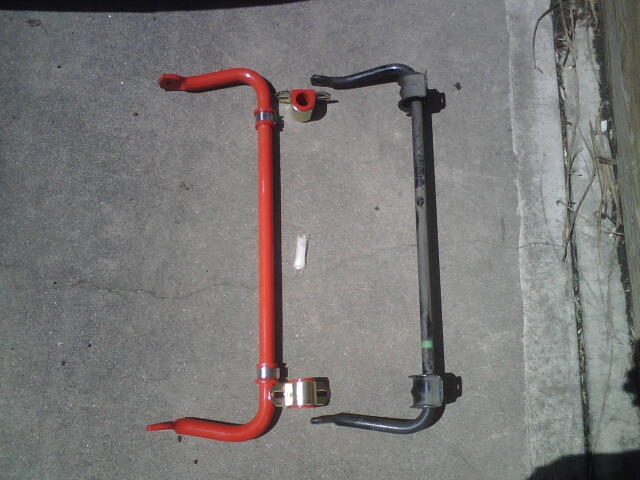

I installed a Racing Beat rear sway bar on the car yesterday. Super easy install for these bars and man what a difference it makes. I'm now laughing every time I take a corner at even moderate speed. Brand new install, very happy.
