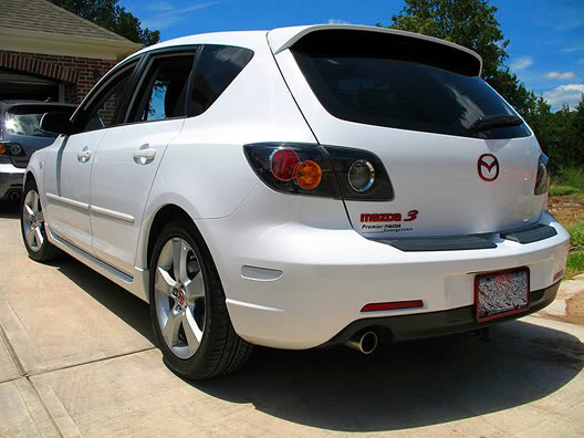

Kinda' looks like this, Tim? (Sorry, perhaps not the best pic for this example.)
That's called negative camber... when the bottom of the wheel/tire sticks out further than the top. Negative camber helps with the stability of the car in hard turns, but also wears the inside tread of the tire faster. It can be an issue w/these cars as the specification is pretty broad.

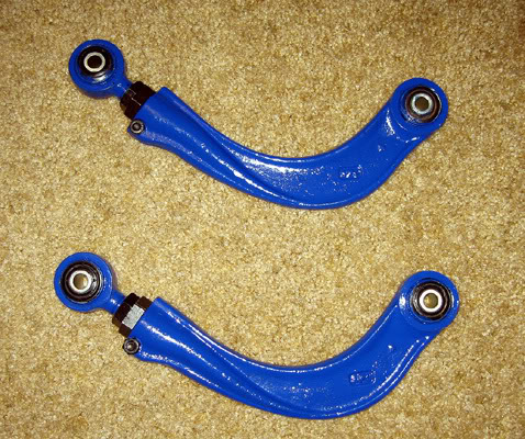

IIRC, -0.5* to -2.0* of camber is considered "normal," or within spec. Unfortunately, the only way to correct for too much negative camber is to replace the upper rear control arm with a longer one or an adjustable one. SPC makes the latter (as do a few others.)
They go for around $200/set, but w/o them, even w/regular tire rotations, you could be going through tires like they are going out of style, or about every 20k miles.

That's what I was trying to tell you. There is no adjustment for rear camber w/o getting adjustable rear upper control arms. So the answer is no, just a normal alignment won't work. It won't make any difference in camber. Only rear toe in is adjustable from the factory.
Think of it this way: You can buy several sets of tires that wear out prematurely, or you can "invest" in SPC's and save in the long run.

The install is not an easy one, but yes, it can be accomplished in one day (or less) w/the right help and tools.
You need to lower the rear suspension between 1-2" (6 bolts) and also loosen part of the fuel system under there. I forget exactly what but these pieces do not need to be removed, just displaced for clearance.
2-17mm wrenches are also necessary, the thinner the better. It's tight in there.
As for adjusting before or after lowering it, I suggest that you look at and go by the specs the car is already at. If near or at -2* already, I'd dial it back a bit. I doubt you will notice much or any real handling changes... but your tires will thank you for the relief.
