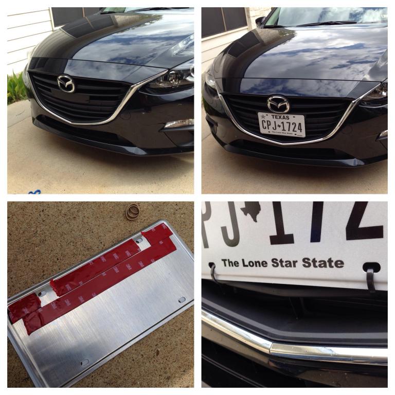

Update: So I decided to go the double sided tape route after reading more good than bad testimonials. I bought a small roll of 3M Extreme tape (paint section of Home Depot) and used that. I went ahead and secured the bottom of the plate with semi-loose zip ties in the event that the tape fails. So far it is holding on super strong. I blasted it with a pressure washer too earlier yesterday to see what it would do and it didn't budge
