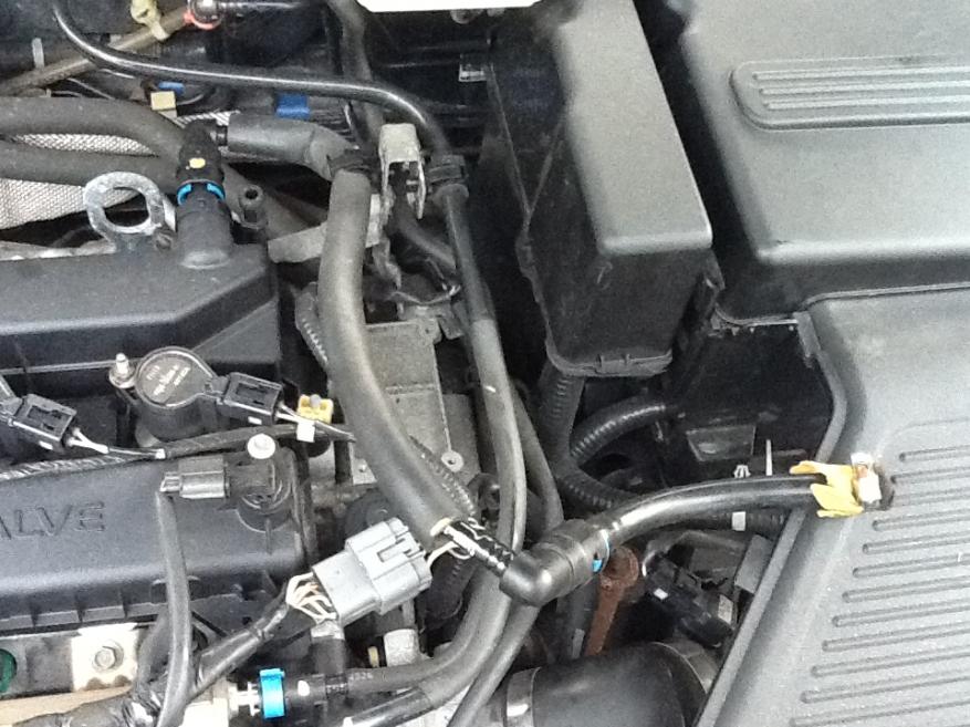

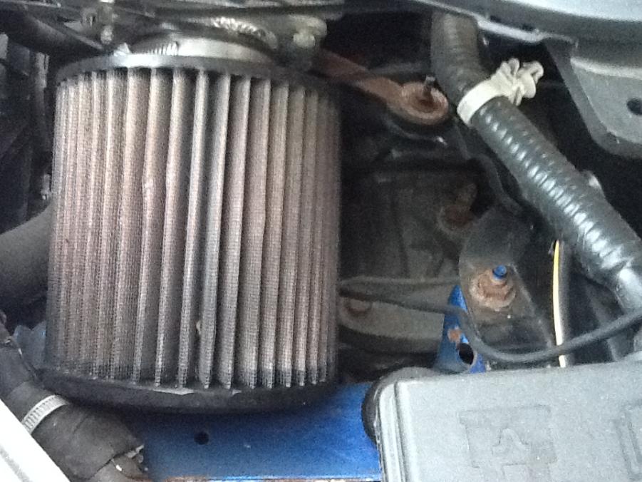

ok, I just noticed something in the engine bay today. I knew the previous owner had put a high performance air filter (phoyo1), but never noticed that disconnected tubing (photo2) which hooks up in the back of the engine. What is it?

It looks like its either the fresh air entrance for the PCV system or its the PCV valve if your talking about the hose with the blue clip on the inside. If that is disconnected you will be sucking in air that is not metered by the engine resulting in your lean burn condition.

I am talking about the hose that connects in the back of the engine on the valve cover. It seems that it is the hose for the recirculating of exhaust from the PCV. Would that trigger the lean condition?
