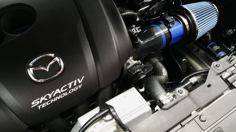

I want to be clear I do not suggest that anyone consider to copy my ratio of coolant to water. I have been using the proper method of ratio mix for over 4 decades without a single failed cooling system . The companies that make coolant will not find fault with my following response and anyone can freely submit it to a company that supplies coolant to MAZDA and post their comments. As long as they are one of the Chemists and not a MAZDA sales representative unless they are a chemical engineer.
Antifreeze/coolant is designed to be mixed by referencing the ambient operating temperature. The 50/50 ratio commonly used was always about ease of use,packaging and DIY retail use friendly sales. Purchasing most 100% coolant has a ratio mix chart somewhere usually the back of the container. In my area the most efficient ratio would be 60/40 assuming I will not drive in temperatures below -10F which I don't. Technically if I wanted to keep the corrosion resistance and increase cooling efficiency of the coolant I should run*70/30 in summer starting in February/March and then use the ratio back up to 60/40 around November/December for winter. I also if change my thermostat to 170F for the summer months. If I could on the MAZDA (maybe in the future) I would access the ECU and change my fan operating tables of operation to support all of the above coolant ratio changes as well. Unfortunately I have not yet found a ECU access program that allows full access for ECU adjustments.
This will all I will be responding about the subject of coolant ration on my thread. The reason for this limited information about this subject is mainly because this thread is about what I personally do and not necessarily for any recommendation nor do I wish to debate correctness or subject empirical supported data on any project.
* at these mix ratio's *70/30 or higher water ratio's I also use REDLINE Water Wetter.

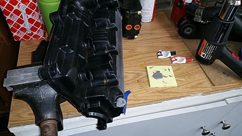

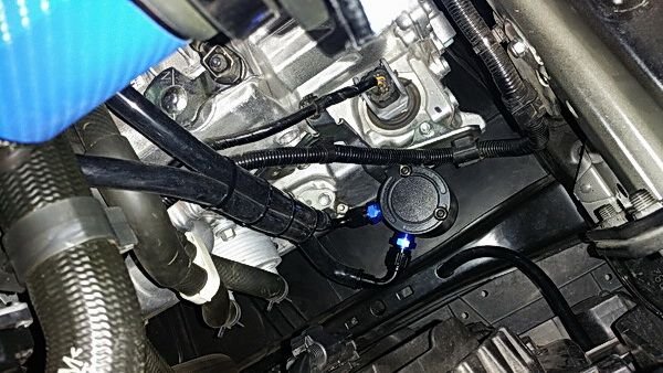

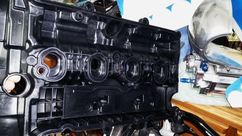

Almost finished with the prep work on the valve cover. But while I
i was sanding I decided to do some upgrading to the valve cover. I never cared for the factory oil fill cap. So that going to get a face life. Also I have a better idea for the breather hose.
The interest thing with doing this project is I understand now why there is very little oil vapor going into the intake system on the skyactiv engine at least with my year 2018. The breather baffle is chambers in a maze that reducing and cool the oil vapor that reduces the oil vapor from the breather side to almost negligible. I will be very curious when I pull my intake to mod it up what I find out about the PCV chamber?
Stock valve cover
A little more sanding on the grey area to smooth it out so it will hopefully look like aluminum when I get done in stead of plastic?

The first area of changing will be to remove the Breather tube from the valve cover. I use JB weld (tested on plastic used on engines) to do a 2 process filling insuring I don't get air bubbles in what will be a new threaded hole.
Now I will let it set up for about 3-4 hours. I use to use fast dry JB Weld but found that it seems to form bubbles in the core of the of filling so I just patiently wait for it to harden with the traditional JB Weld. Ok while waiting I am going to go prep my Turtle for a race. LOL

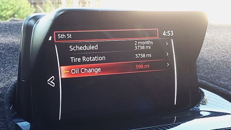

Not really wanting to do much of anything today and waiting for the JB Weld to harden on the valve cover project I decided to do an early oil and filter change. This go around I am using Mobil 1, 5w30 for the summer temperature months.
