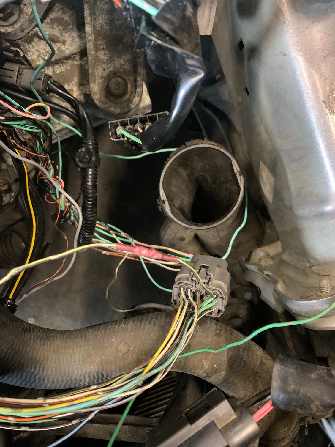

Mazda 3 no start new motor fuse 69 blows every time you turn the key have checked all grounds Ecu is new and programmed and has signal Mazda 3 2.3 L is a manual car

Fuse 69 looks like its for the fuel pump relay. Remove the fuel pump relay, replace fuse 69, turn on they key & see what happens.

Pulled fuel pump relay fuse blew and wire in image started smoking
black and yellow wire from connector witch goes back on the harness from the fuse box to blue black and yellow is the only wire smoking

Depending on your skill level, you may need to tow it to either Mazda or a auto sparkie. That wire will need to be tested / traced to seen whats going on.
