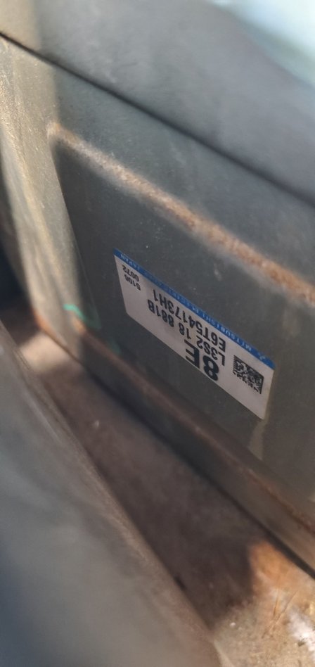

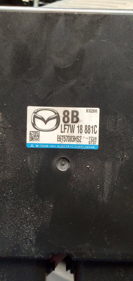

Hey everyone. New member here.
My car is a base model mazda 3 year 2008. It had the 2.0lt and its auto.
Engine took a **** and I got a really good deal on a 2.3 liter engine from a 2004. I used the 2.3s harness and everything pretty much plugged in fine. I also picked up a 2.3 lt computer from the junk yard .
I finished installing the motor and it wont even crank with the junkyard ecu. But with the 2.0 ecu it cranks just wont start. I do not have access to the computer from the engine or keys
Here's pics of the 2 ecus
2.3lt ecu
2.0 stock ecu

You will need to get the 2.3ltr PCM programmed to the vehicle.

The immobilizer system needs to communicate with the new computer.

You will need to take it to Mazda for programming.
