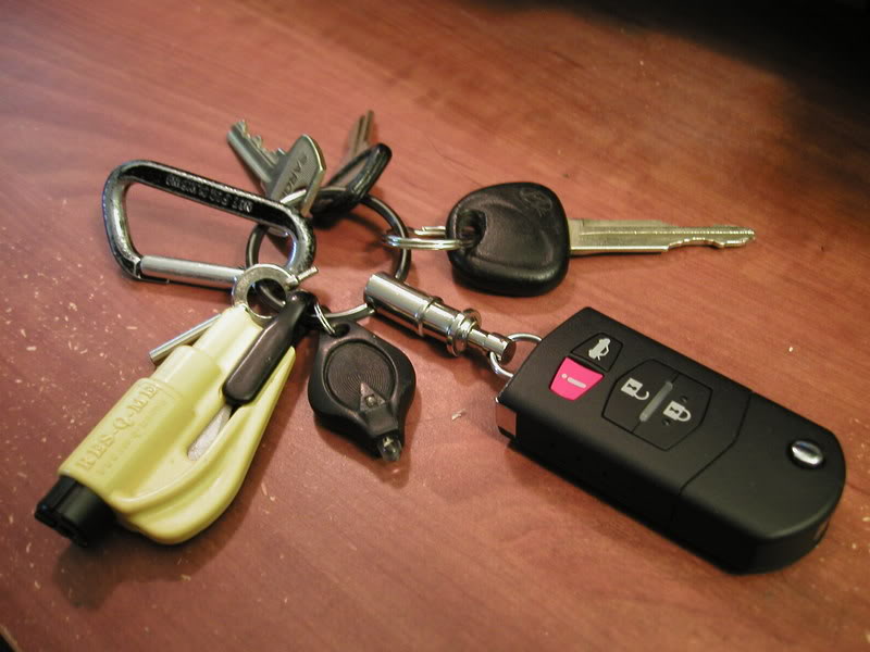

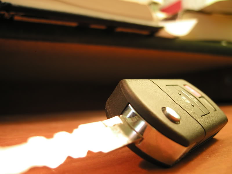

Basically the way the key system works is each key has a unique RFID coded chip in the handle. In order for the keys to work the codes have to be input into the computer in the cluster. You can do this yourself if you have two working keys in hand and can add up to eight keys.
insert working key 1 into ignition, turn to ACC, wait for immobilizer light to turn off
remove key 1 and within 10 seconds insert working key 2
repeat first sequence for key 2
remove key 2 and within 10 seconds insert unprogrammed key 3
repeat first sequence for key 3
repeat for every new key you wish to program
That's it. The reason I recommend getting a third key (or making sure the dealer gives you two) is otherwise getting replacement keys is expensive and annoying. This way takes about 15 seconds.
If you don't like/want the key fobs then no worries. The flip key is a single housing which has the keyless remote in one half and a key blade which flips open at the push of a button when you want it.
