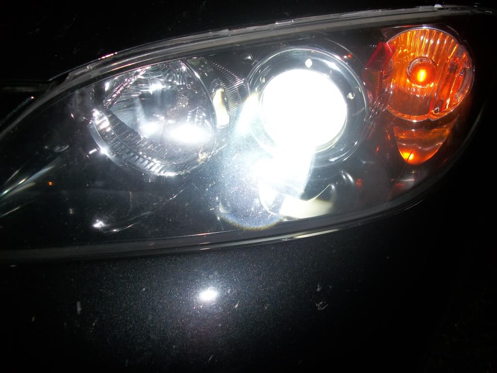

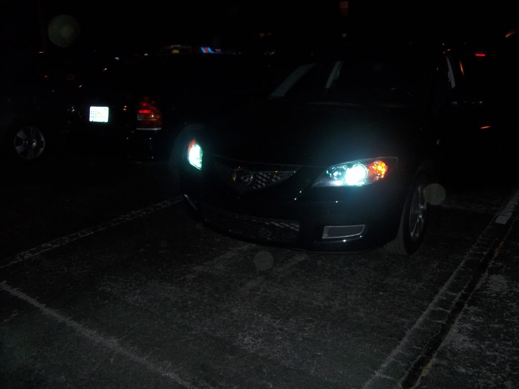

nope i needed the harness, made one yesterday and both work perfectly

i see what your problem was, you got only half of the hid kit, what you bought is just like a replacement kit of the ballast and bulbs go bad wires included, i got mine for 50 shipped, plug and play, cool that it worked out for ya though
