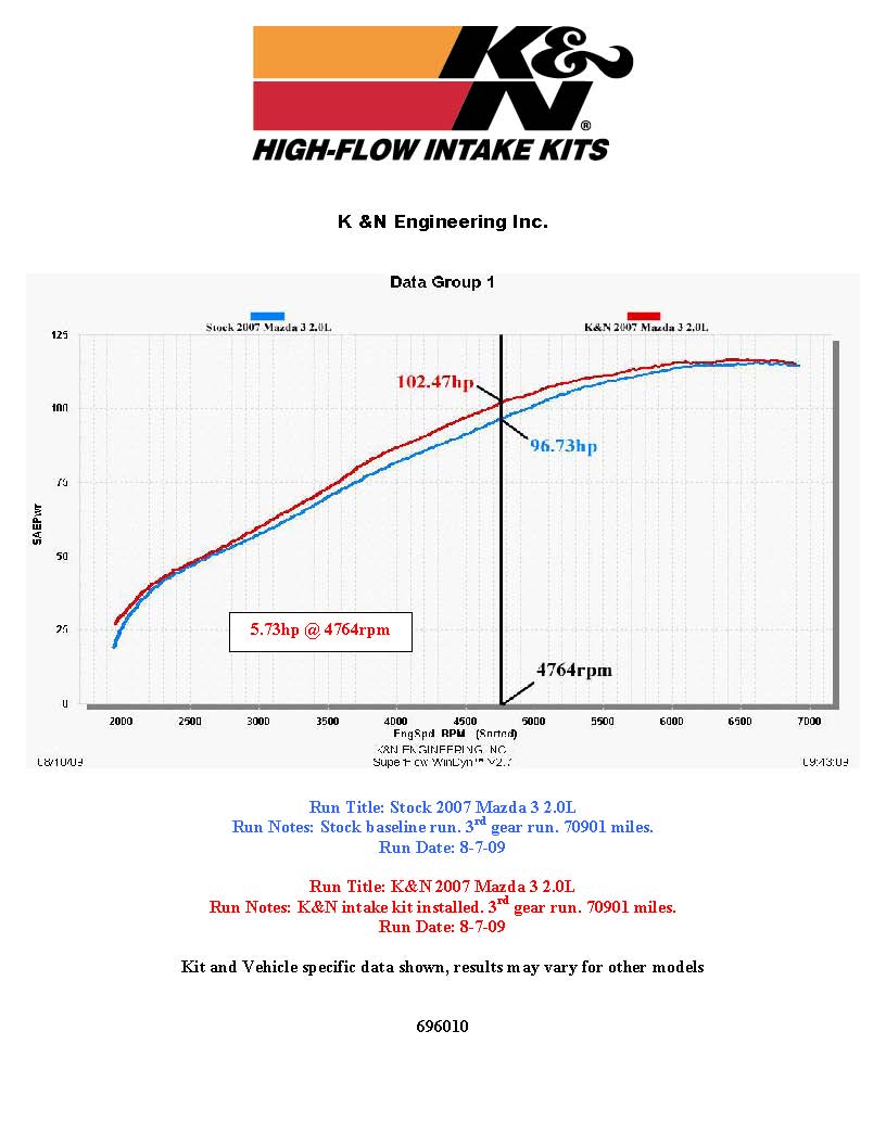

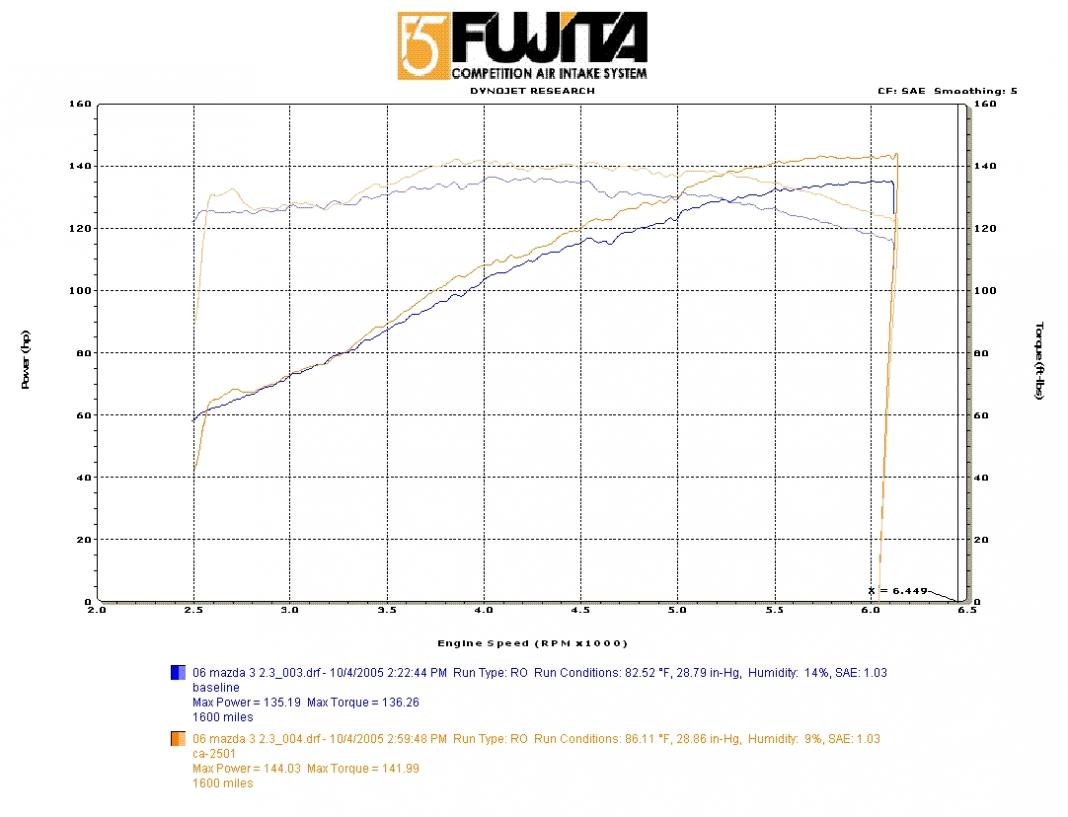

Here's K&N and Fujita.
Attached Thumbnails Cold Air Intake Advice Needed-k-n-dyno-69-6010_dyno.jpg   Cold Air Intake Advice Needed-fujita-dyno-06%2520mazda%25203.jpg

Interesting graph, but I don't consider 4,764 RPMs to be "midrange". Looking at the 3,000-3,500 realm I see virtually zero difference.

It shows a slight increase around there. But the intakes do claim the main point of increase around 4500
