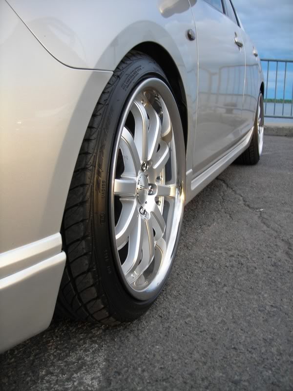

alright, i got a PM back from the guy.
he said if i go with a 18x8 rim, the widest tires i can go are 215/40/18. however, the tires will be stretched...
like this.....
he said he ran with 225's once, and he rubbed. not alot, but he still rubbed....
i tihnk i might head out rim shopping on my next day off and find myself some 18x7.5 rims......
like this.....
