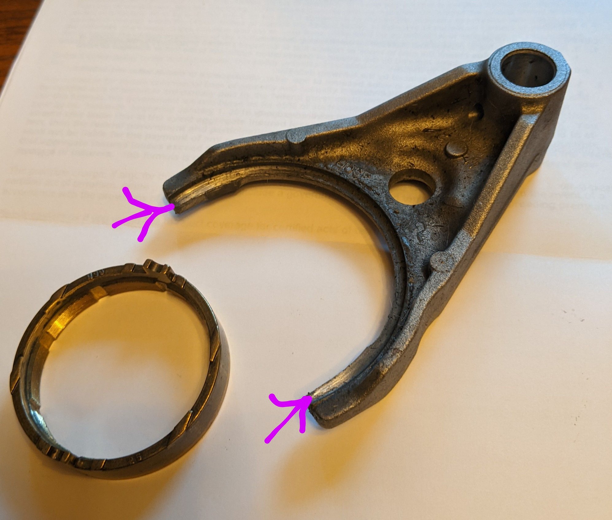

Default Picture of the shift fork and synchronizer ring

If you car is "5th gear slipping"... the "shift fork" is a very likely culprit.
It seems to be aluminum (softer metal).
Now, the part of the shift fork that "wears out"... is on the "inner side" (aka, toward the engine) of the shift-fork. Therefore you need to take out the shift-fork to inspect it.
It is not that hard. You remove a big 32mm nut, and there is a "pin" you take out at the bottom of the shift-fork. And it will come out.
Take some pictures before disassembly. I would also "yellow crayon" mark (or some paint or something) on the outside of the "gears" that come out .. so you can but it back together without reversing the gears.
After you take it off, look at the "inner side" of the fork.
Mine was obviously worn...and its probably like 2mm or something like that.. but it is enough to cause the slippage.
So obviously the repair here is to "replace the bad shift-fork with a new one".

Ok... so the shift fork damage (wear and tear) was very obvious.
I decided that "while I was in there", to change the brass-like material "synchronizer ring". Maybe I didn't have to change this, but maybe I did (??)
The new one and old synchronizer was close (as far as noticeable damage on the old one), but at the same time, it was $50 or so...and the older I get, this was a small price to pay for not having to open it up again.
So below are the part numbers I ordered.
If nothing else, if you find the mazda online parts catalog images, you can find the part on the image to figure out how to find the part(s) for your model.
The "internal transmission" diagrams are a little confusing on which inner transmission parts "go where?".
GC0317265 Ring, Synchronizer.
G50217406C Shift Fork.
F52017628 Nut, Lock.
I got all of those for under $200 IIRC.
The "nut", you may be able to re-use your existing. But you may damage the nut when you "un-indention" it to allow it to turn. (It is exactly like a CV axle "nut" where you "dimple/intent" the nut on installation.
Obviously, when you take apart your shift fork assembly, you may want to visually inspect everything. But the parts seem to be made up of 3 materials.
The aluminum (?) shift fork. The brass (?) synchronizer ring. And the super hard steel (?) gears. And the aluminum and brass seem to be the primary maintenance parts.
My advice: If your money is more important than your time, if there is damage to the shift-fork, just replace that.
If your time is more important than your money (again, we're talking < $200 for all the soft metal parts)...then get all 3.
One more piece of advice. I did an online order for the parts on Sunday night.
I got an email on Tuesday afternoon that "2 items are back ordered". GAAA!!!!
So even when you find a good price mazda genuine online parts vendor... call them before ordering online to make sure they have them within a decent amount of time.
The next place, I called them and there were like "we have 2 of them on the shelf, and I can get the third in 1 day, thus the parts will shift in 3 days". That was acceptable for me. But keep in mind, this is not a "next day" type of situation.
I'm 2 weeks into the "after repair".
My 5th gear does not slip. In cruise control too.
The one thing I was more aware of is not to "agressively push hard" when I put in 5th gear.
And to keep my knee off of the shifter.
And the lower gears shift more smoothly. I think my correction of the low-level-gear-oil is the reason for the more smooth shifting.
So in a nutshell.
Remove and inspect the shift-fork.
Drain the existing gear oil. Pay very very close attention to refilling the transmission.
Make sure you get the correct amount of gear oil back in.
While you're 'in there', highly consider replacing the synchronizer ring.
So the pink/fuscia arrows show the wear and tear on the shift fork. The wear and tear goes all the way around the half circle.
YOu can see the "shininess" of the wear.
The round brass object is the synchronizer ring .
