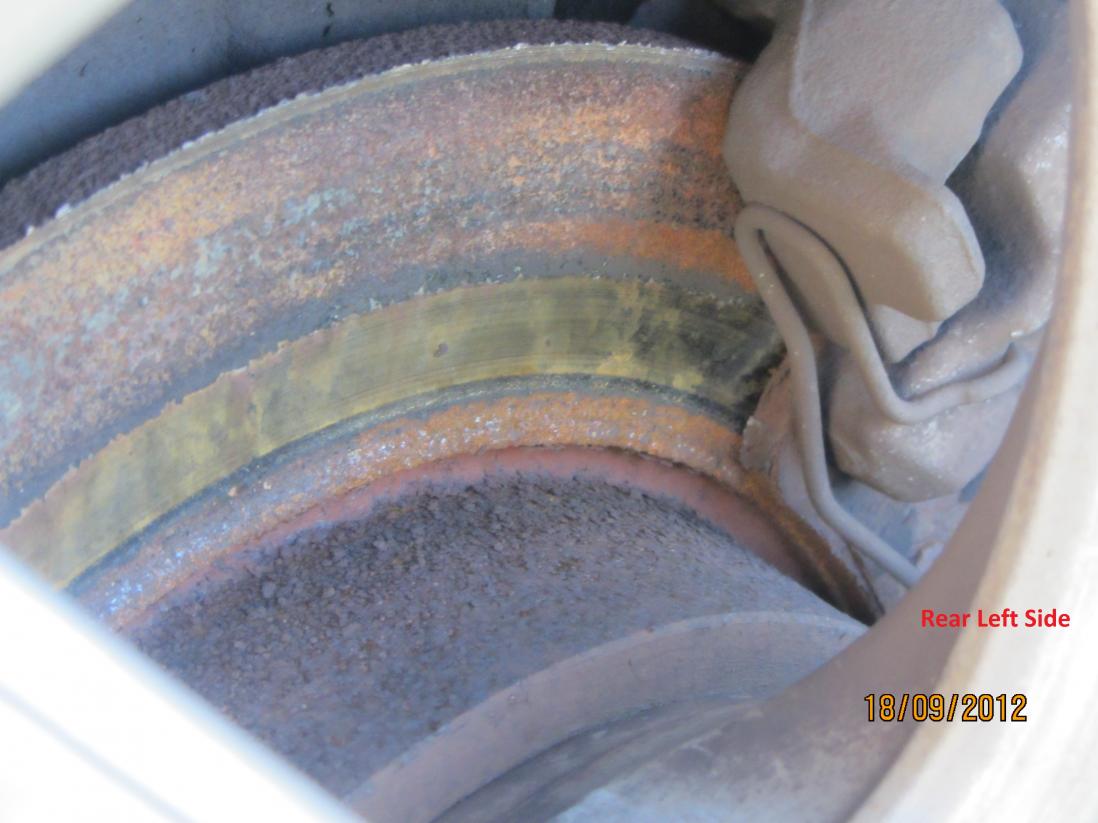

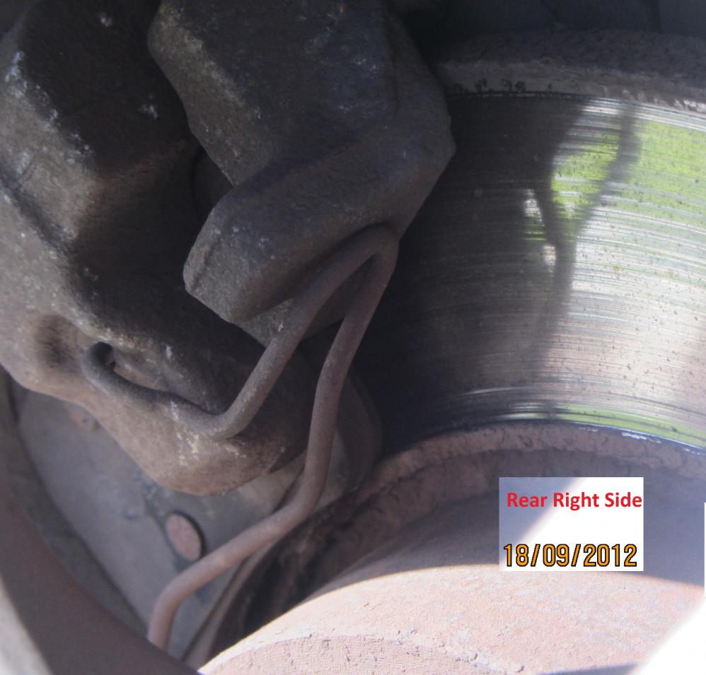

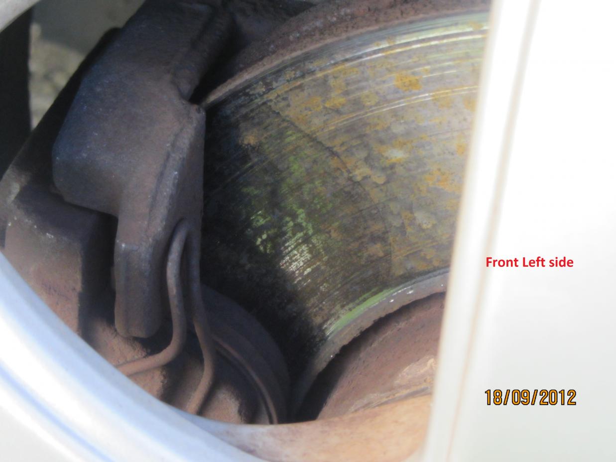

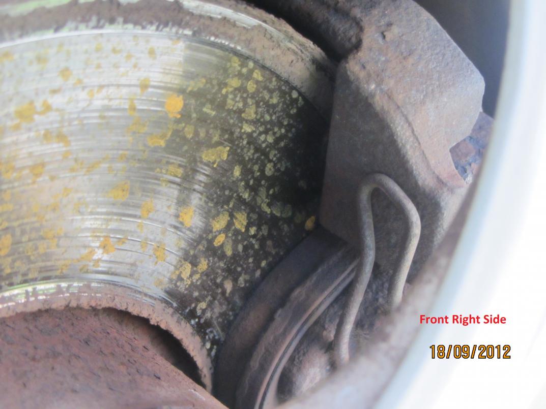

The brake pads look to have some meat on them. All four were changed 30K miles ago. Would they be due a change? Also, what makes me think they need to be changed is there is a low scrapping noise as I am braking. It continues for a second even after I stop. The brake discs on one side of the car are discoloured (rust?). I was thinking they need to be changed too
I general, the car runs ok for one with almost 120K miles. The tires wear evenly and the only noise is the one I mentioned when braking. No smells or visual queues. I don't think there is much rust but I'll find out when I get working on it

Well those are some great pics!
The left rear is definitely NOT working right, same with your front right, there are bands on the rotor where the pads are not even contacting anymore. What makes me think a bit is why the right rear has no rust on it at all, plus its pad is pretty thin. It looks like you need to do a complete brake service, new pads, possibly new calipers and definitely new rotors. Did it rain last night?
I'm in Ireland...it rains most nights
And it did rain last night. The left side of my car would be more exposed to the weather due to the way I park st my house
So new pads, discs and calipers all round then?
And it did rain last night. The left side of my car would be more exposed to the weather due to the way I park st my houseSo new pads, discs and calipers all round then?
And brake fluid
