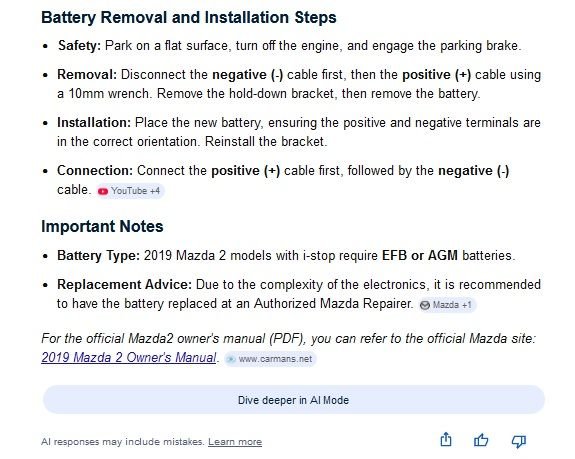

Hi to you all. I've been wanting to buy a Mazda 2 for a while. I picked up ours 2 days ago. A 2019 Mazda 2 GT Sport Nav +. I'm new to this forum, but not new to engineering. I have obtained a workshop manual, and been reading about battery disconnection/changing. It appears that the sensor attached to the battery negative terminal monitors voltage, current and temperature data, that is recorded in the Power Control Module (PCM), (Engine ECU if you like). If you intend to disconnect the battery for any reason you need to record the current data in the PCM, then reinstall this data when the battery is reconnected, as it losses this data on battery disconnection.To this end you need a OBD2 code reader. Is there any recommended code reader for this. There are a lot of cheap ones available, but I know some are good and some not so good. I'm less worried about price, more about easily doing a reliable correct job. Thanks In Advance.

Yes, that's what Googles AI seemed to be saying. Not sure if I believe that or not. Does that work the same for a new battery? How does the PCM know that you've fitted a new battery? There seem to be a number of scan tools available, and Google AI is saying buy one that does "battery management system reset, or battery registration"
best mazda code reader for battery change - search
