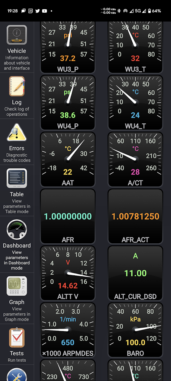

Seems your alternator isn't getting excited without a load. Maybe the internal voltage regulator is failing?
Here's idle, no load (well 11A): 14.62v at alternator, 14.2v at ecu.

How to test internal voltage regulator if failing?
What I've noticed is when under load I have over 14V and.......... drive I have over 14V BUT......... I when I slow down to 5MPH or stop - charging Voltage drops to about 11.8-12V for about 1 second and back to 14V again it can be even heard in slowing down fan speed - and this happening all the time - something like ECU knows I slow down/stopped and change charge level? Is it internal voltage regulator thing?
