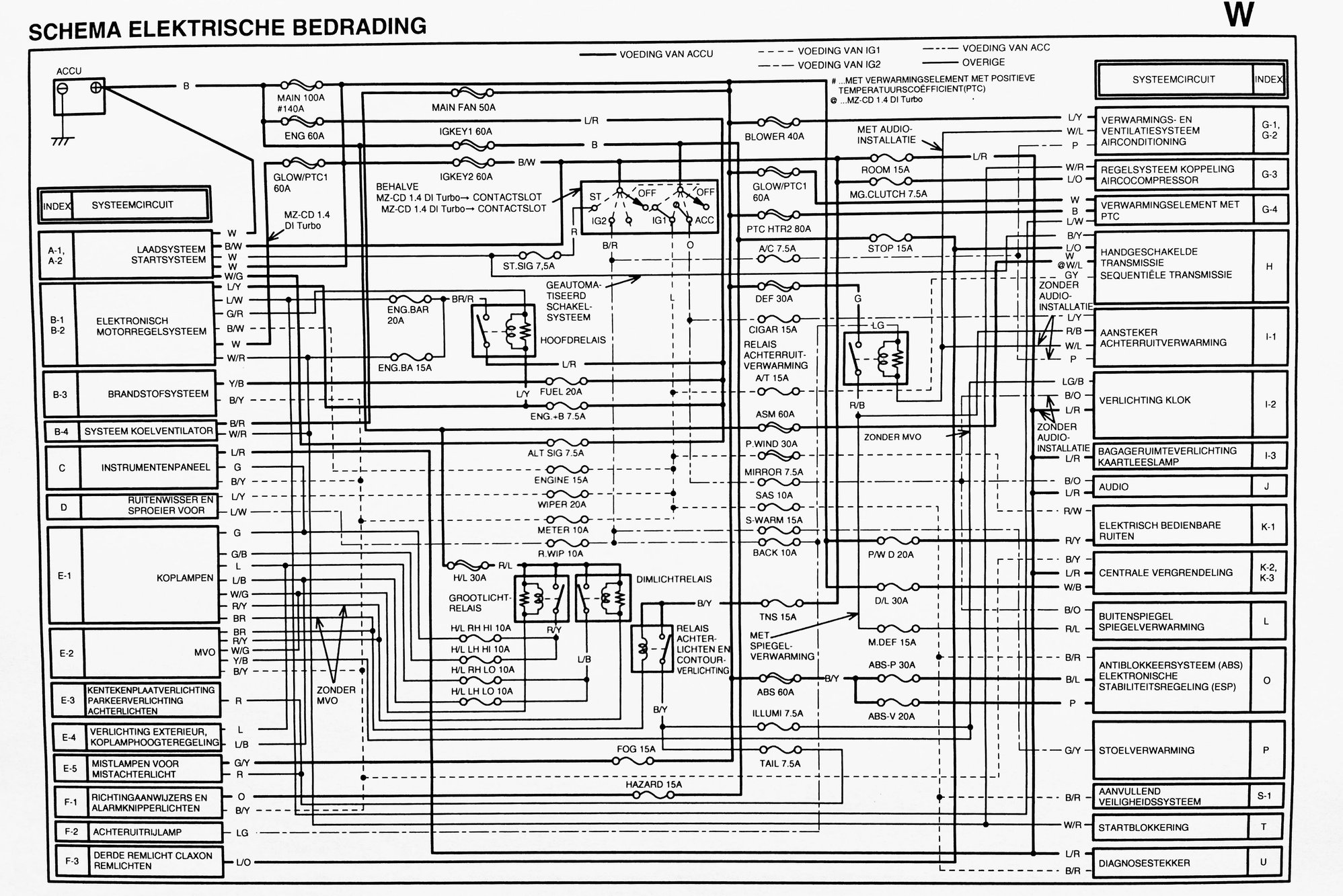

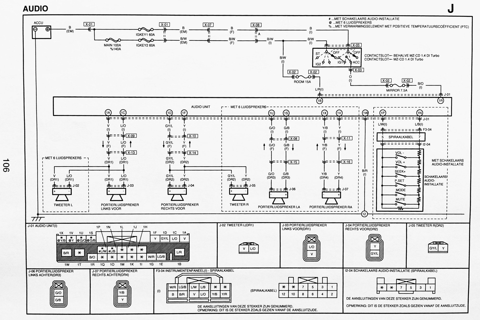

Found schematics after a long search.
After removing the old (and defective) CD-player from the audio unit, the high current draw is gone. (Is now lower than 30 milliAmpères).

For more information about solving the issue (short version);
1) Removed IGKEY2 60A fuse ---> issue gone
2) Replaced IG2KEY2 60A fuse. Removed ROOM 15A fuse ---> issue gone
3) Replaced ROOM 15A fuse. Removed J-01 (main) AUDIO UNIT connector ---> issue gone
4|) Replaced J-01 AUDIO UNIT connector, and tried to insert a CD into the cd player. Did NOT insert a CD (CD detection sensor defective?)
5) Tried to insert a cd with the eject button. The cd was fully inserted, but the player gave a rattling noise, and also showed "NO CD" message.
6) Pushed eject button, and the CD ejected.
7) Removed CD player AND the CD player print circuit board (the CD player print circuit board is in the same compartment as the CD player) ---> issue gone
