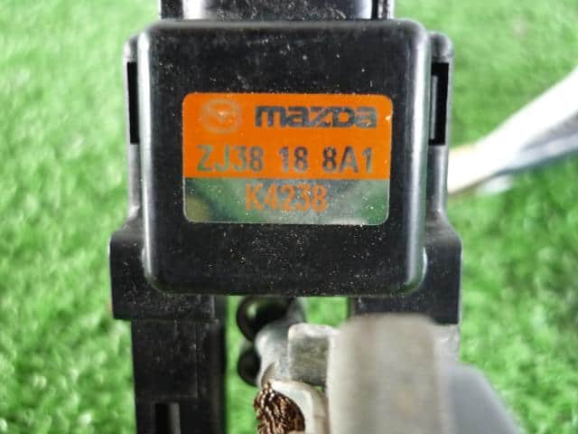

Hello, I recently acquired a 2010 Mazda Demio/2 and I'm running into an issue with the air conditioner. I checked all the fuses and relays, they're all good.Checked power to the compressor and evap fan motor, all good.
The system just wont tun on when activated, the system worked fine I'm told, but stopped working. The system is charged and pressurized.
Any ideas on what I am missing that could be causing this issue? I did notice some corrosion on the ground terminals and clean it up best I could, but will replace the cables.
Also, could anyone tell me what this device on the negative terminal is and its purpose, thanks.
Used]Demio DE3FS Electrical Equipment ZJ38188A1 - BE FORWARD Auto ...
