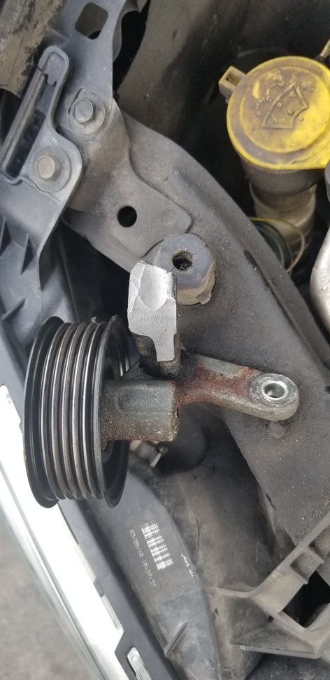

Finally I found the source of oil leak.
The stud of idler pulley that is on Timing Cover broken!..
I'm very disappointed((
Looking for replacement timing cover.

Originally Posted by simonsi
Ouch! Thats a real shame, hope you find a cover ok, biggish job to change it.
The job is half-done Only Harmonic balancer left to remove(screw is too rusted)
I paid a "Timing Cover" from a local Mazda dealer for 250CAD+tx. Picking it up tomorrow afternoon. Will play with it mostly on Saturday.
Just by curiosity the cost of replacement at dealer site is 1200CAD!!! :O CRAZY!!!
Thanks again for support!

Hi all.
Today I replaced Timing cover.
The biggest challenge was to remove Harmonic balancer bolt. After few tries with impact wrenches I made an additional tool and finally the bolt was "broken"!
Tomorrow morning I will fill the oil and will test it.
Have a great Sunday to everyone!!!
