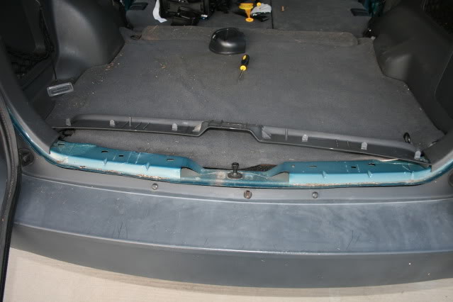

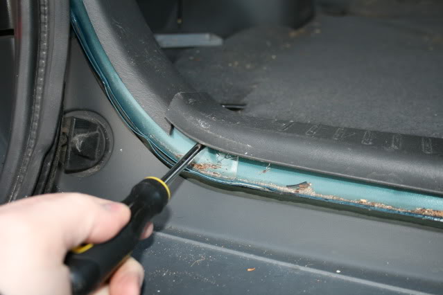

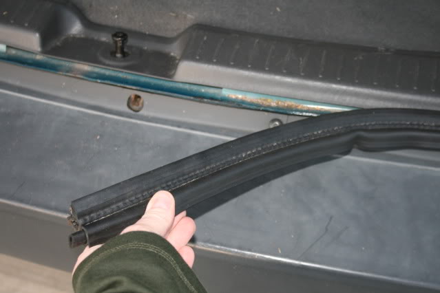

Start by pulling the weatherstripping loose in the middle of the rear of the car

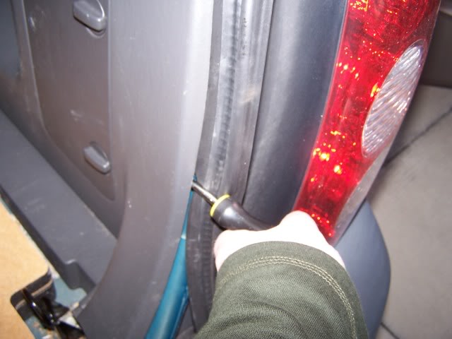

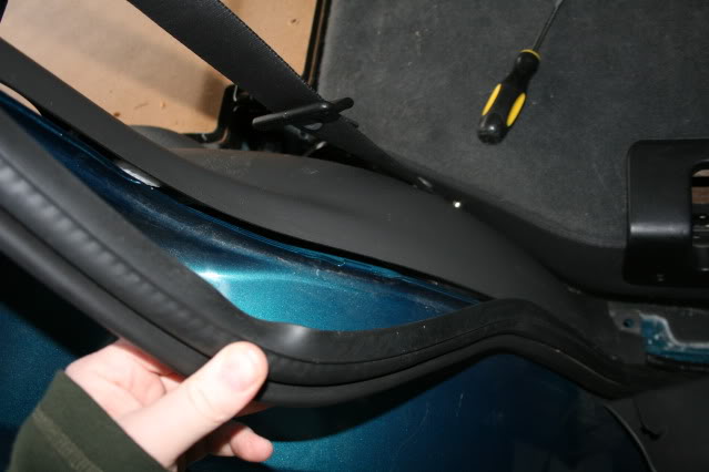

Pull it off on both sides about to the corner

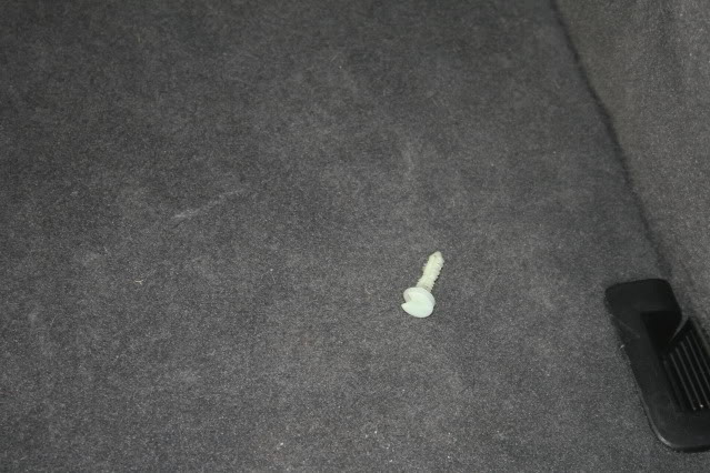

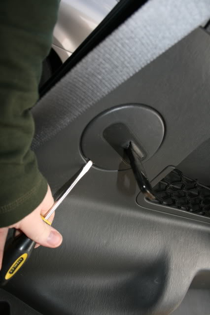

Take a flat blade screwdriver and gently (hey the whole world is made of brittle plastic these days) pry up to pop the plastic clip loose
Continue until the plastic trim comes completely loose
looks like this..dont mind that stain..god knows what that is

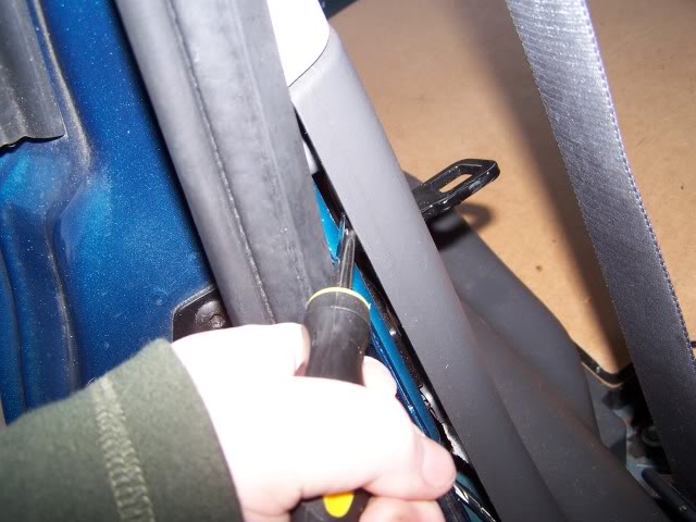

Then move up to the back door ( i did passenger side first but it dont matter)
pop the trim circle from the seat locking bracket

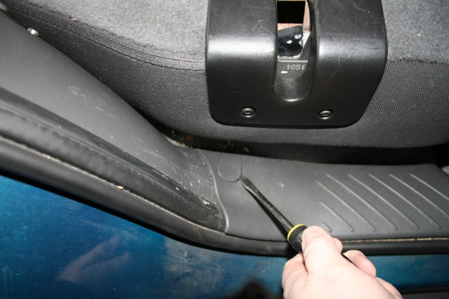

Then look down and find the plastic cover on the kickplate plastic trim and pop it open with a screwdriver

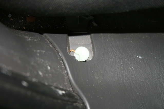

This is probably the hardest part of the whole thing..You pry,swear, pull etc to get the trim piece and that little plastic "pop-it" out

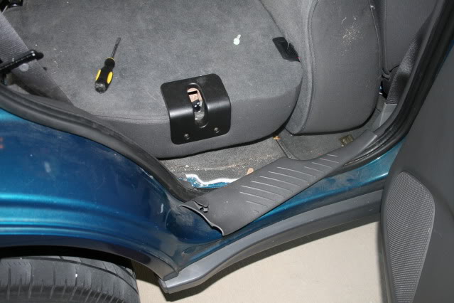

Looks like this when you get it out
The plastic is bendy so you can just pull it out of the way like this

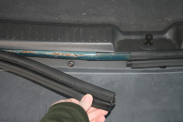

Then pull the weatherstripping loose along the rear panel

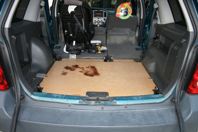

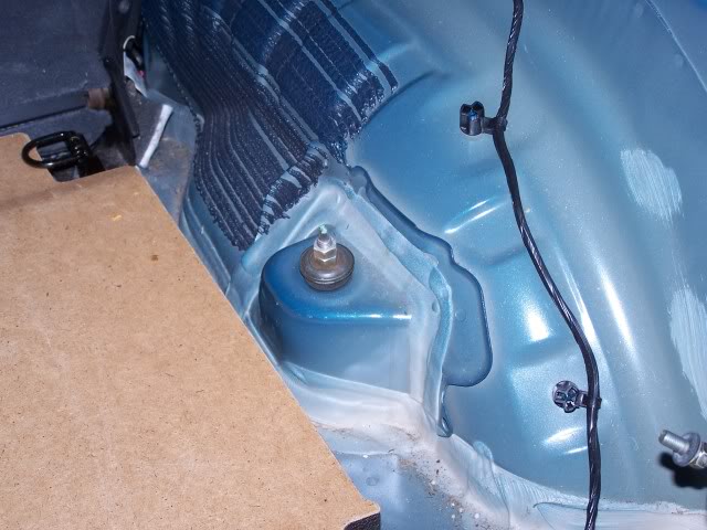

The only tabs that should still be holding are under the window..Just get your hands under and behind the panel and give it a firm tug..It'll let loose.
And there it is..the top of the shock!
You did it..now just repeat the process for the other side and go get a beer or six.
