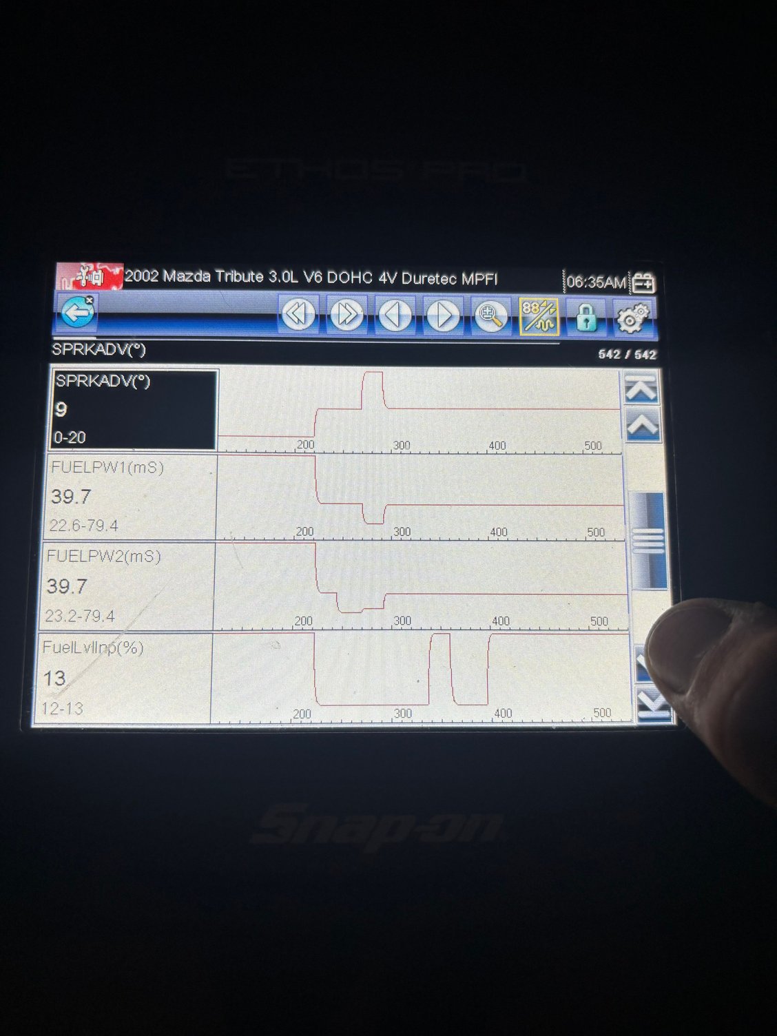

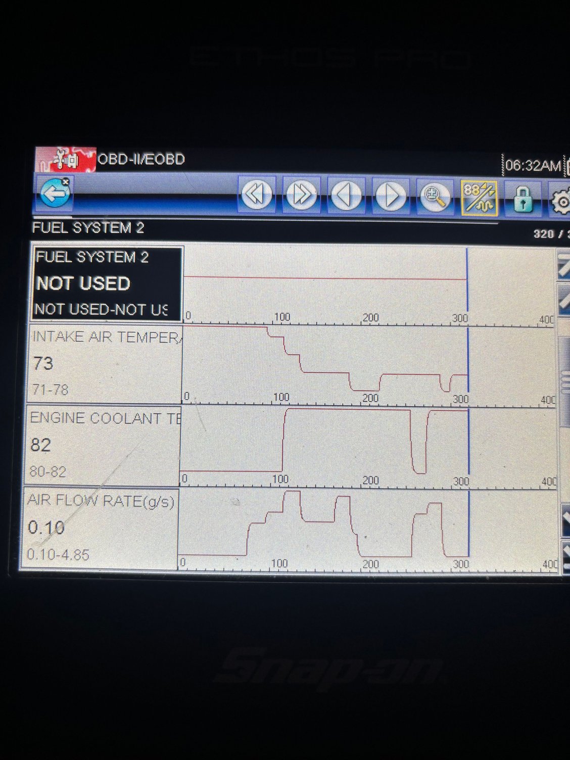

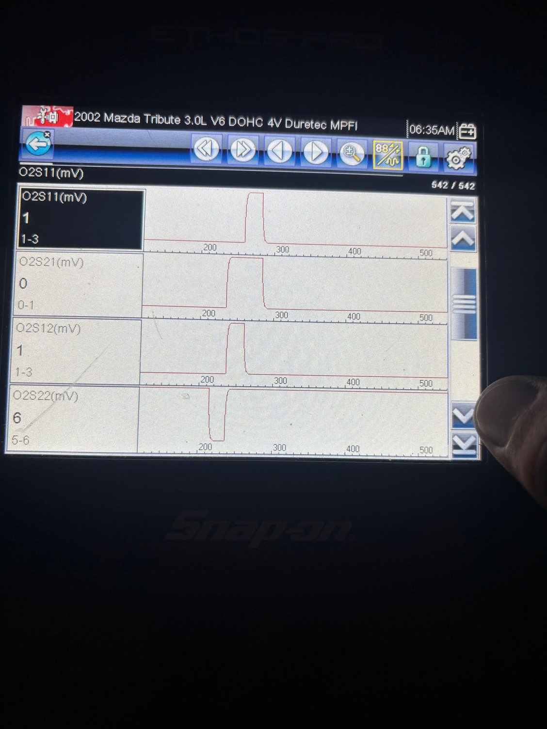

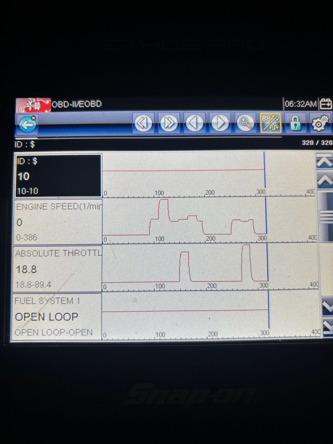

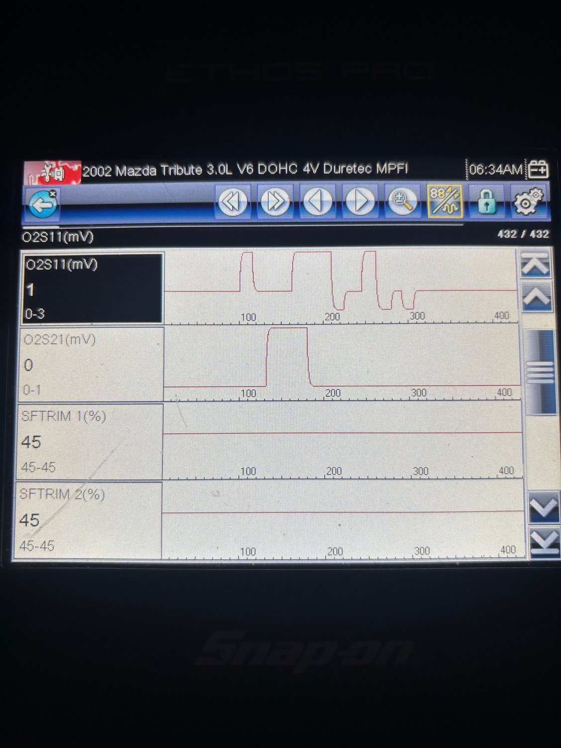

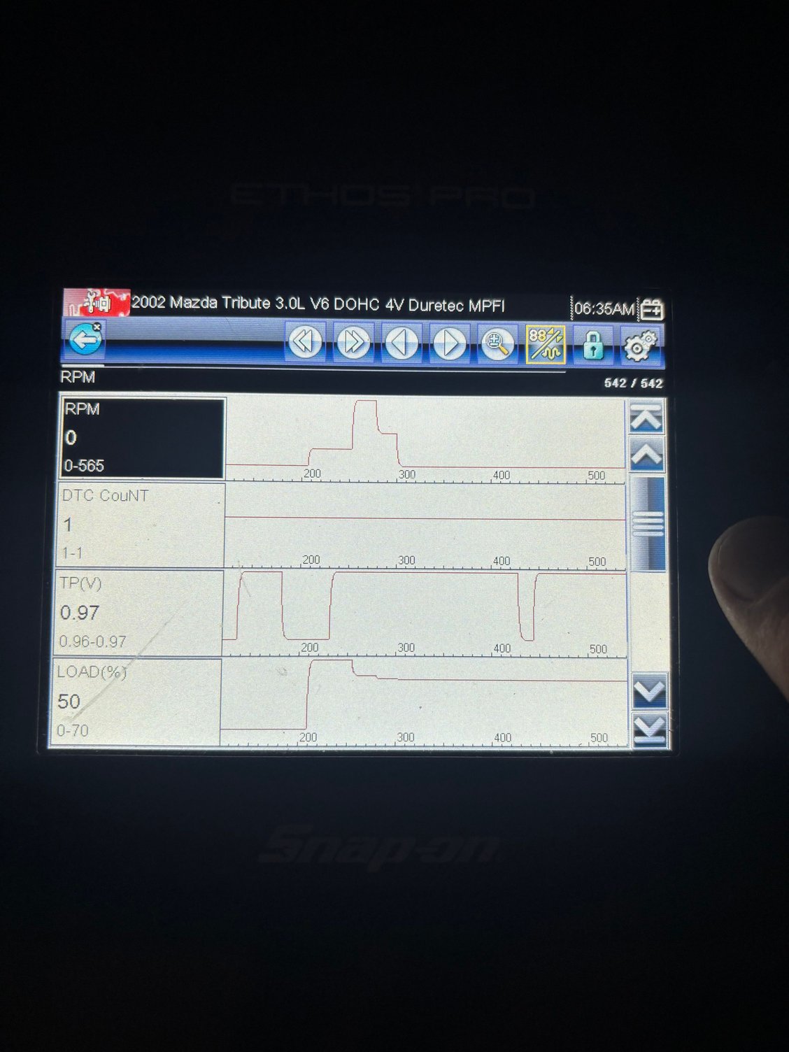

Hey guys sorry about the previous post about measuring voltage on coils. Your messages before that did not load so I didn’t see that you guys ruled that out. Thank you so much for the insight. I will send a video of starting asap. Also. I do have a snap on ethos pro scanner I can use anytime I’d like. Is there certain live data things I can look for that can help me pinpoint the possible issue. Thank you guys!

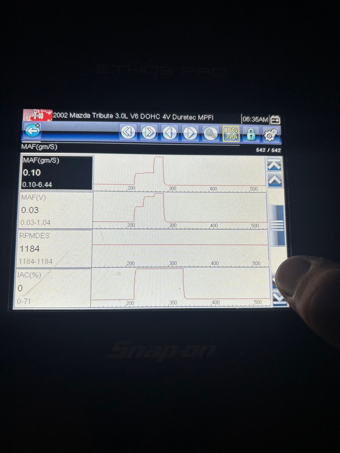

I just wanna say the did not actually start when these measurements were taken

Also one more thing. It’ll crank and crank and crank. I pull the fuel pump fuse. It’ll crank and start right up and run until it’s out of the fuel in the chamber. So it’s gotta be a over fueling flooding issue correct?

Sounds like that but it's strange that it won't fire till you pull the fuel pump fuse. I would have thought it would have a gut full of fuel by then and still take some cranking to start. It's almost like the fuel pump is causing a voltage drop but I would think that would blow a fuse. Not familiar with your scantool so it might take some time for me to decifer the data. What I do see is many sudden sharp changes in what I would have thought should be stable.

You data indicates you should be getting DTC and other reporting information in your ECU.
Re-read post # 5.

Hi I have checked all possible places for any kind of permanent dtc I believe there’s an option for it but it says there is no dtc. I will keep looking though. Is it possible timing off causing because the spark plugs are firing at the wrong time?

Ok but you missed looking at your I/M monitors?
Lets do this. Disconnect one of the coils and try starting the engine. Now you have just created a DTC relating to that cylinder. See if the ECU reports that?
