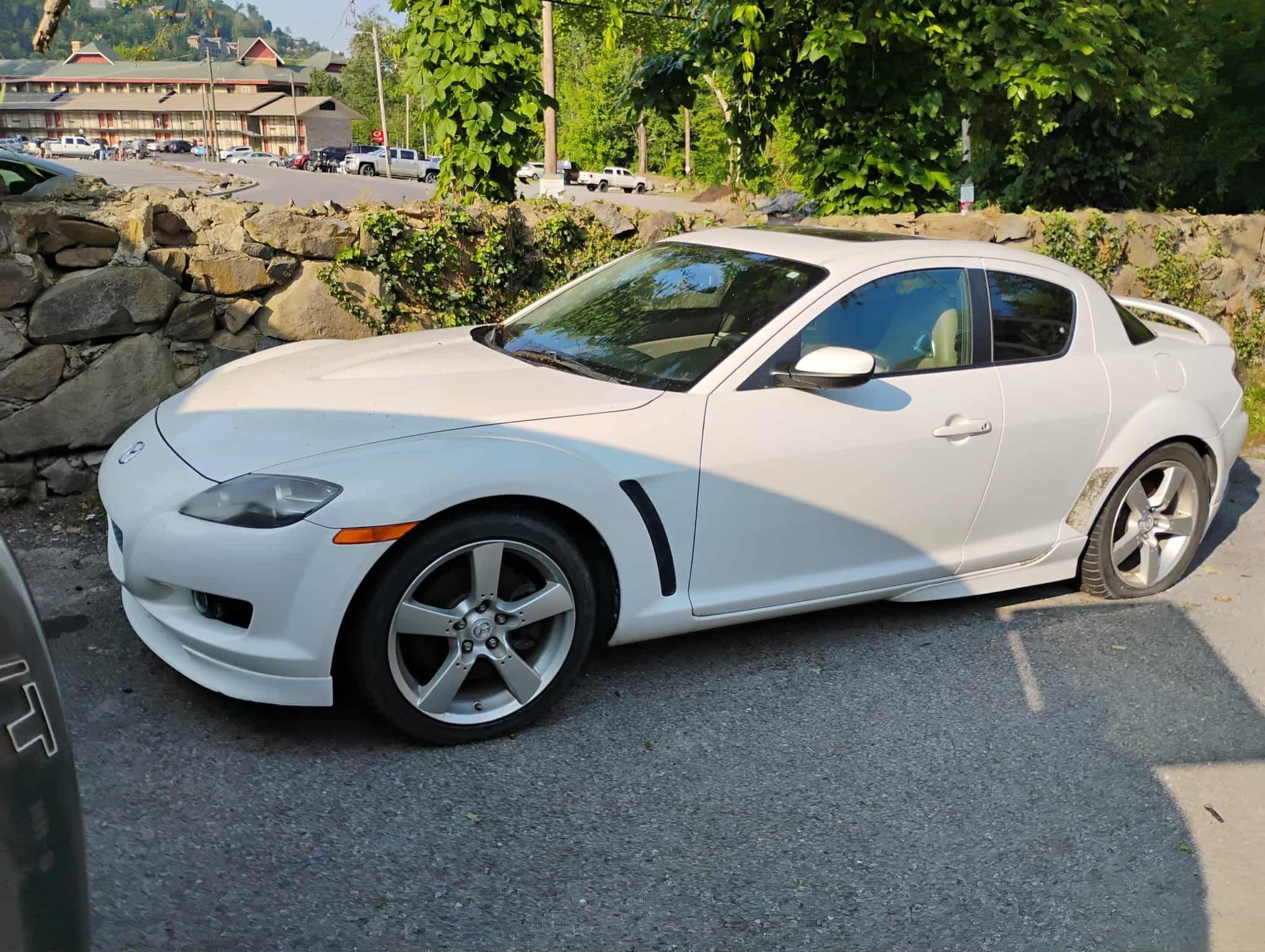

So I just bought my first Mazda and it is a 08 Rx-8 and I have a few questions as I dont know anything really about Rotory motors.
ok so the guy in bought it from was telling me I have to mix 2 stroke oil with the gas but everything I am reading online says it is not required but will help extend the life of the engine and seals.
1. So fo i have to mix the gas if I have NO plans of racing or drifting the car?
2. I stalled the car the first time i tried to put it in reverse bc i didnt know about pushing down on the shifter and when i tried to start it back up it didnt want to start, he said that these cars are bad about that and it has to cool back down before it wants to start again. Is this normal or a possible mechanical issue?
He claims the motor was recently completely rebuilt and only has 300 miles on it since the car reads 9800 on the dash.
I would greatly appreciate any help and guidance anyone can give me please and again new to owning this tyoe of car so please excuse my ignorance.

It sounds like the previous owner may have done some mods and one being disabled the auto lubrication system. That being the case you would have to add oil to the fuel but in the correct ratio. I suggest you find a workshop that specialises in them for an assessment of the car and advice on how ta care of it. Their easily destroyed.
Old Sep 20, 2025 | 08:23 AM
I agree with what Charlescrown has posted. The factory oil injection system can be unreliable. If its been disconnected then you will need to premix / add oil when filling up with gasoline.
