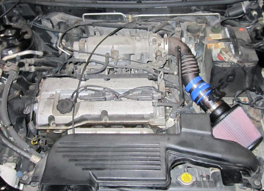

Ichecked all hoses, no leak whatsoever, I remove the MAF sensor and I clean it but same problem, clarification this is a round 3" air filter btw. I decided to put the old filter back on and Poom magic like new. The point is that today I decided to purchase the panel Kn air filter and what do you think? It works fine! and sounds good! Okay, just wanted to point out that I read about some symptoms about a bad MAF sensor and it says rough idle its one of the symptoms and my car vibrates like crazy in idle and making my memory this sensor hasn't been change so it has aprox 133,000 miles, so to resume things I believe it was the sensor all along.

READ: https://www.mazdaforum.com/forum/new...cs-post-30904/ to learn how to load a pic we can see.
If it's a K&N intake for that vehicle it should be fine. If it's a no-name intake with a K&N filter you may have problems.
You may need to get an air straightener: AEM Mass Air Flow Straightener
Again, vaccuum lines that went to your stock air box must be plugged. Any solenoid attached to your stock air box must be removed from air box and left plugged in somewhere under the hood!
That SRI (short ram intake) will not benefit you. After driving around in the city for 10 minutes or so, you will experience Heat Soak. Which means you will have no power. You will be sucking in very hot air from under the hood which is in direct path from the rad fan. I know, i've been there. You need to create a baffle which prevents hot air from rad fan getting to it which must be sealed to the hood.

Yes and no: if I understand you right you have not changed the sensor, only the filter. It works with the original filter and with the K&N filter but not with the 3" cone. As I said there is something wrong with the way it was installed or the cone itself. The fact that it works with the old filter and the K&N pad proofs that the MAF sensor is o.k. Somehow when you put the cone on not all air gets metered.
Follow Noggin's advise.

See my picture I re upload it! BTW thanks for the advices
