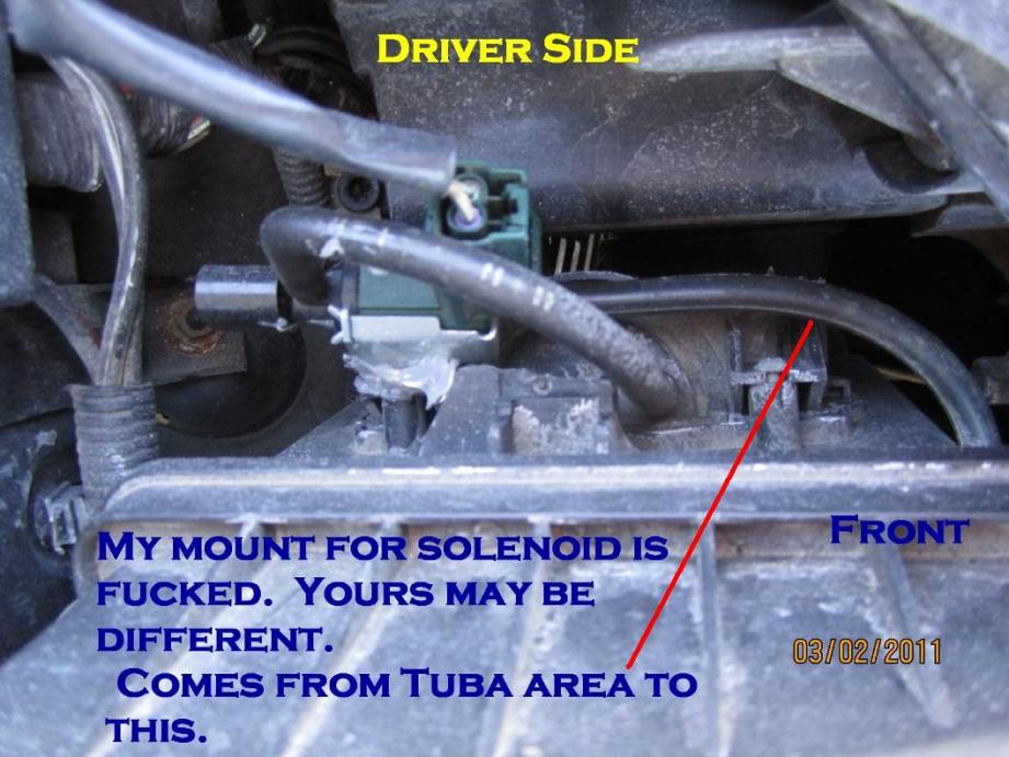

Ok I have almost everything sort out but you told me something about a solenoid, and the obly thing I see is an air hose that comes from the engine and connects to the intake See pic, so I dont get that,and if this benefits you the Intake is the OEM intake of the car with the KN 3" filter
You have to excuse my retardiness but english is not my first language

I am not familiar with your particular car but giving you a heads up on what to look for.
I have attched some pics from my Mazda 6 so you can see what i'm talking about. It's attached to original stock box and needs to be removed from original stock box (if you have one - it controls an extra intake flapper that open as you stomp on gas pedal) and remain hooked up (other pic). Mine is green.
I discover something my car doesnt use that solenoid I checked the stock air box and it has no solenoid and I dont see a place where it can be connected so I think my model doesnt bring the solenoid from factory probably because mine is a 2000 model and yours is 2006
Lucky You!
Just plug up your vacuum line.
