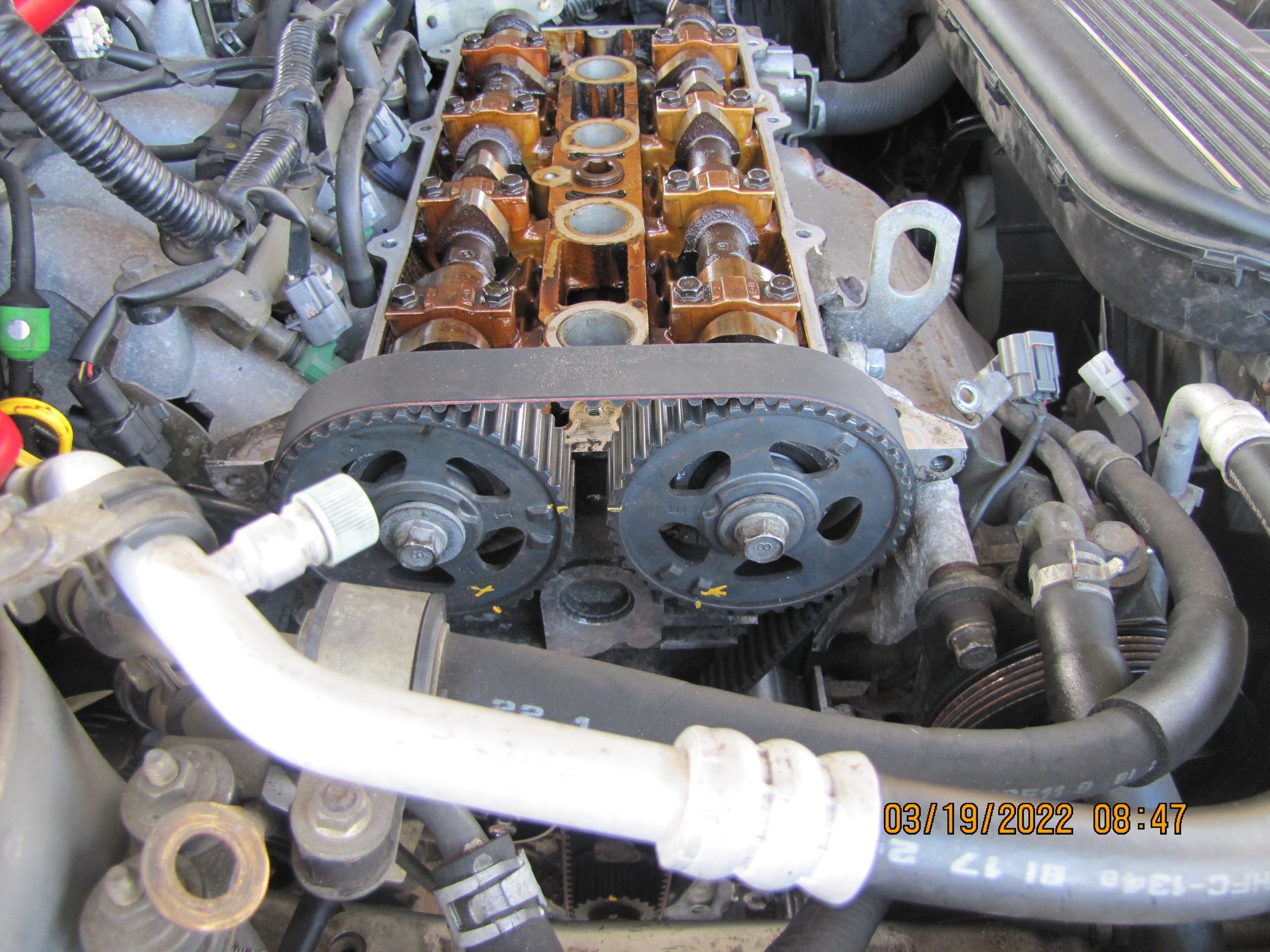

Now I will let you all see if you can guess what I did wrong.
Here is a picture before I corrected the mistake.
Phil

Assuming, that is the camshaft timing alignment procedure for that exact engine, it should be I( intake cam ) to E (exhaust cam) not E to I
( some Mazda engines use timing marks at 12 o'clock, some at 5 & 7 o'clock )

Ya timing is off thats why it wont start. Thats why it sounds like a grinder when trying to turn it over.
Easiest way to remember is like what Grim said. I should be on the left because thats where the Intake manifold is and E is for Exhaust because thats the exhaust side.

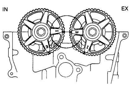

The marks you painted should point at each other in a downward 45 degree down angle. The marks you havent painted will line up then timing is correct and car will start first click.
Should look like this:
My guess is whoever took the sprockets off, reinstalled them in the opposite order so marks were off.

Very good I was beginning there wasn’t anyone here that worked on these things.
The engine sounded normal the original time when I said the timing seemed to be advanced to far was a bad Camshaft sensor. The new one stopped all of that. But the engine still would not run.
I visually verified the camshaft timing buy TDC #1 and found # 4 to have both lobes in the proper position and #1 to be TD C exhaust with both valves open. This is normal this engine apparently has 4 to 6 degrees valve lap at TDC exhaust.
So with everything appearing to be correct I sat down with the manual again.
I then found just exactly what you have pointed out.

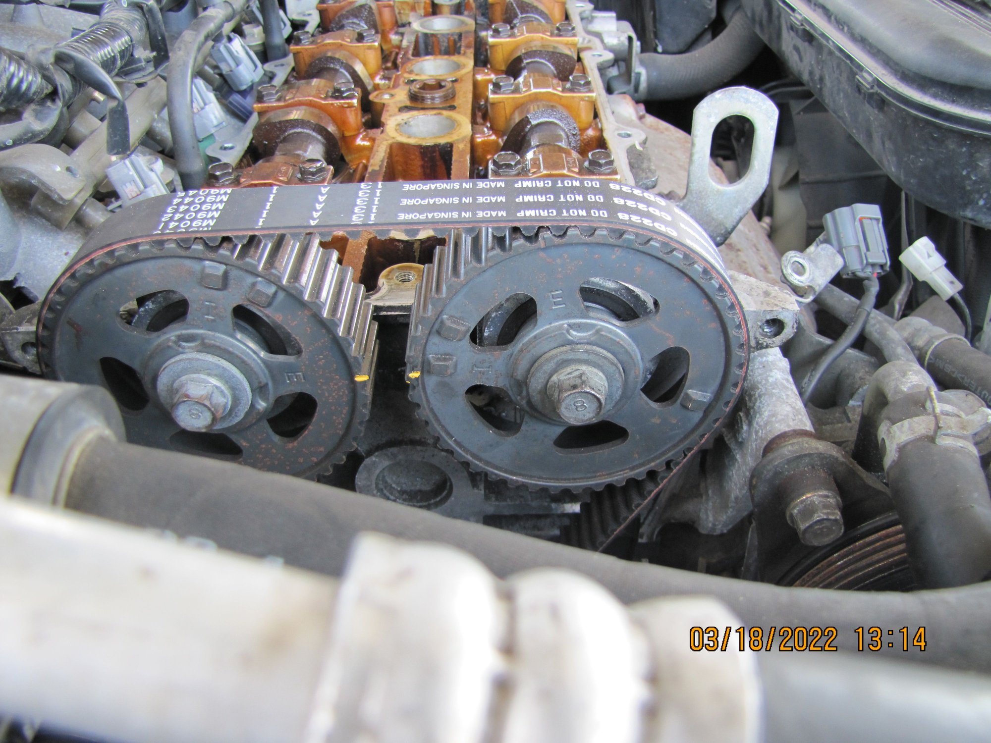

Wapwapwap the gears are made with both markings on them if you look close at the picture you can see the correct marking at the top of the gears. This was totally my error the gears are made that way as a manufacturing cost cut they only make on gear for both sides.
It now runs very well.
See attached picture.
Phil
