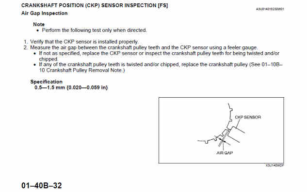

this is a that thing what you're looking for
