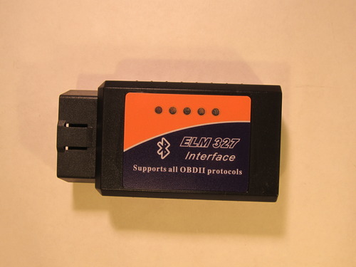

Also, I recently bought an bluetooth obd2 reader from Amazon and this app from googleplay called Torque pro: https://play.google.com/store/apps/d...l.torque&hl=en I tested my car for fault codes by hooking it to my car and turning my key to the on position just passed the accessory position and it connected fine, but didn't get anything back. I always thought that cars send out fault codes whenever it doesn't start, so I was sure that I would get one. To test this reader out, I disconnected the maf sensor harness and got P0100 Mass Air Flow (MAF) Circuit Malfunction. Did I check for fault codes correctly?

I don't know about the bluetooth stuff.
