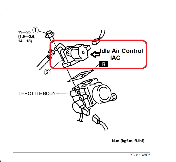

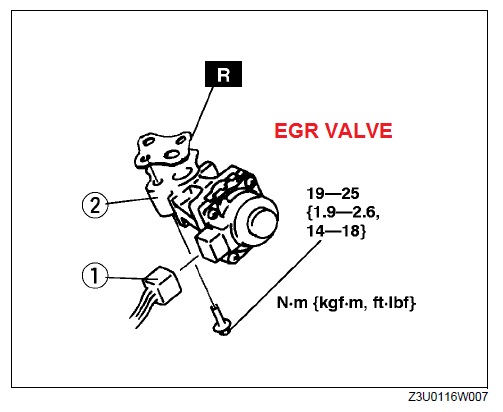

You can try cleaning the IAC valve, and then the EGR valve.
The IAC solenoid has a plunger assembly that can get gummed up.
Use carb cleaner to clean it.
The EGR valve is a little harder to remove, but it can also be cleaned with a coat hanger and carb cleaner.
My car was stumbling, with the idle going up and down.
I started with the IAC valve, and worked up to the EGR valve.
I don't have pics , but you can look on EBAY to see what they look like.
If I remember correctly, they are both near the throttle body.
