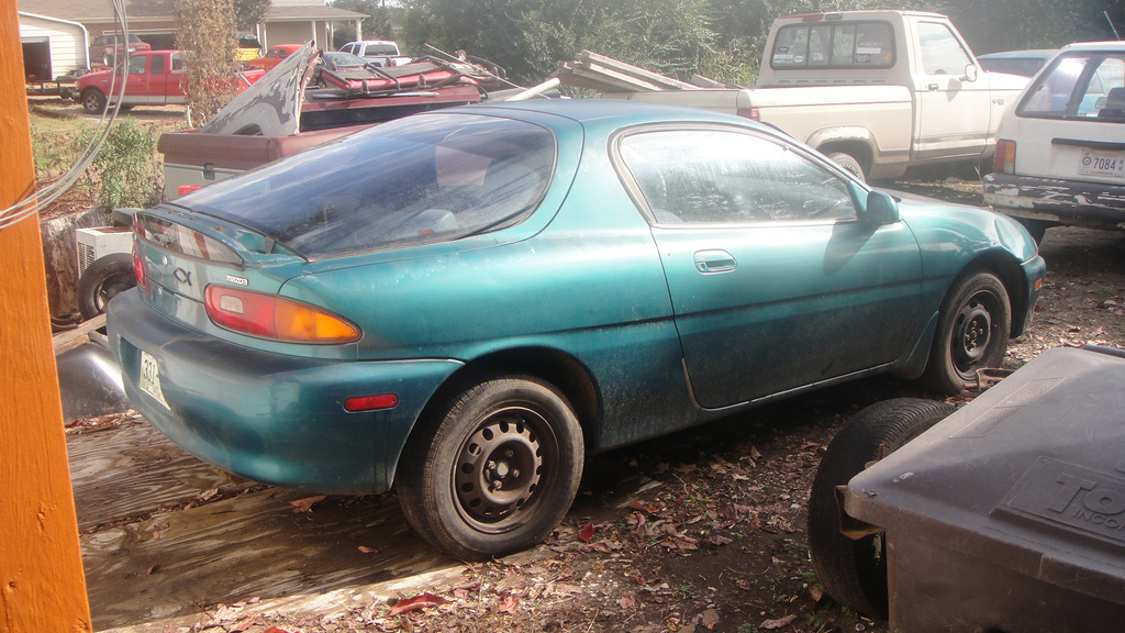

Here's the car after it's first bath:
I posted about this one in the new member area, and someone asked if it was some kind of joke, dunno why.
To drag it home, I disconnected the shift cable at the transaxle lever, and pushed the lever into the neutral position right there on the trans. So the problem is definitely in either the shifter or the cable. I/WE tried putting a jumper pack on the car because I know some Japanese auto-trans cars have a solenoid that prevents the car from being taken out of park unless the key switch is on. No joy!
I suppose it could be a bound up cable, stuck shifter, bad linkage, something jammed somewhere, or just a switch or release I either don't know about (YET) or that isn't working.
I also know for a fact now that it's a non-turbo B6D.
