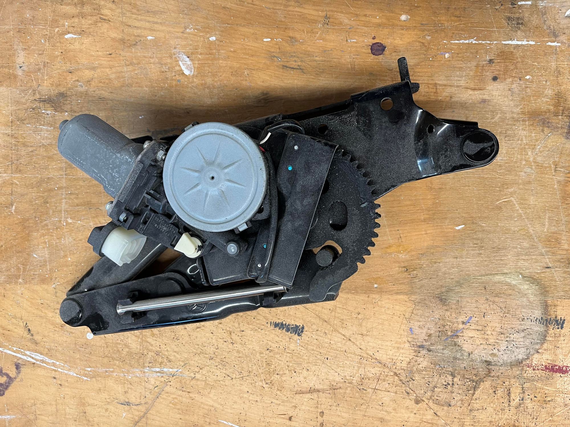

Hello,
The two limit switches are located on the right deck lid motor assembly only. They are on the inside (toward the center of the car) of the large black gear driven by the motor. You won't see them at all unless you have removed the deck. In order to remove the limit switches you've got to adjust the mechanism so you can get a philips screwdriver through the holes in the gear to loosen the mounting screws. I ended up disassembling the unit in order to get them both out. There are two pins on the backside of the big black gear that engage the spreing-steel arms on the limit swithces. If the arms are bent or misaligned, the switch won't activate and the beeping continues. Here's the better fix, in my opinion, and I've just done this and my top now works just like new. I bought a whole right decklid motor assembly from a partseller on Ebay. Paid about $95. Easy to get in and out (once you take the decklid off) and the switches come with it. There is a motor currently on Ebay. Here is the link: https://www.ebay.com/itm/17576942166...AABOJZL0ewujPg. This guy is a good seller. These don't come up for sale all the time, so I'd get it if I were you. I will probably buy another one in the future just so I have it on hand. This solves the switch problem and anygear-slippage or stripping that may have occured because the switches weren't operating properly. If you've heard any kind of grinding or popping sounds as your deck is lowering down, its likely that the pinion is slipping in the gear, and you're going to need to replace it. Get one of these. I will post some pictures but they are not real good ones. This is my old one. First picture is of the whole unit (retracted configuration). This is what you get on Ebay. The switches are on the back side of the black gear. Notice the black and white electrical wires coming out the top. Second picture is looking edge-on at the big black gear. You can see the two spring-steel arms of the limit swiches and the black pins that engage them. You can't see the switches because they are behind the arms. The third picture is of the second electrical plug on the unit, which services the limit switches. The right-side motor assembly has two electrical plugs, one for the motor and one for the switches. The left-side unit has only one, for the motor. Hope this helps, and good luck.
