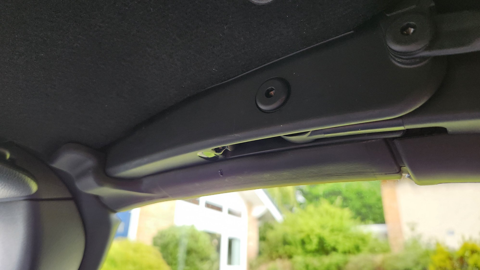

Hi, I am new to owning a mx5 and recently purchased a 2019 ND. I recently noticed water dripping from a little plug in the hood bracket above the driver’s side window. It only leaks after heavy rain and when the car is moving. I am guessing that water is finding its way into the hood somehow and collecting in there, then the car moving is enough to vibrate the plug and let it drip out. it is only happening on the driver’s side and I have checked everywhere I can think and it all looks good. I have attached pictures so you can see what I am talking about.
I was hoping someone might have had a similar issue as i am tired of walking into work with a wet arm and leg.

If it helps, I found this thread for a 124 Spider which is having the exact same issue. unfortunately they never posted the solution.
https://www.124spider.org/threads/wa...vy-rain.34110/

About three months ago I used Autoglym fabric cleaner and Renovo ultra proofer to clean and reseal my ND's roof. It helped a little as it only leaks in heavy or prolonged periods of rain however It did not solve the issue as some mornings the seat is wet and water drips onto my arm while driving. I have noticed that if you pull back the rubber above the window on the interior there is a little strip of roof fabric that sticks out a little which is always heavily saturated whenever the leak appears. I don’t know if there is a gap between the metal strip that the exterior rubber strip slots onto and the roof fabric that is allowing water to pass and get inside. could also possibly be a small tear in the roof fabric or it may even be seeping through the fabric.
