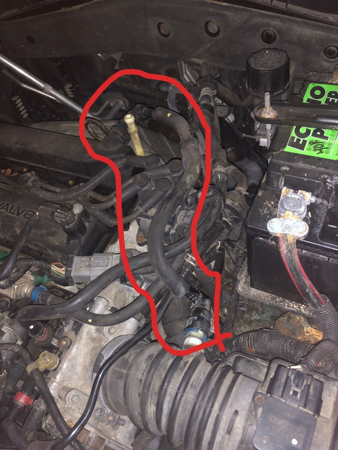

Hey. I’m new to all fhis. I’m trying to figure out what this hose is called and what the pieces on the ends are called to replace them. This is a 2005 Mazda 6 4 cylinder 1.3L engine 5 speed.
One end piece
Other end piece
Hose is outlined in red

Rocker cover breather hose/pipe.
Goes from the rocker cover to the intake hose/pipe.

So those pieces can all be causing lean to idle bank 1?
Old Jan 22, 2020 | 06:30 AM
Absolutely. If there is air leak in any part of that hose, the computer can't detect it and goes crazy.
