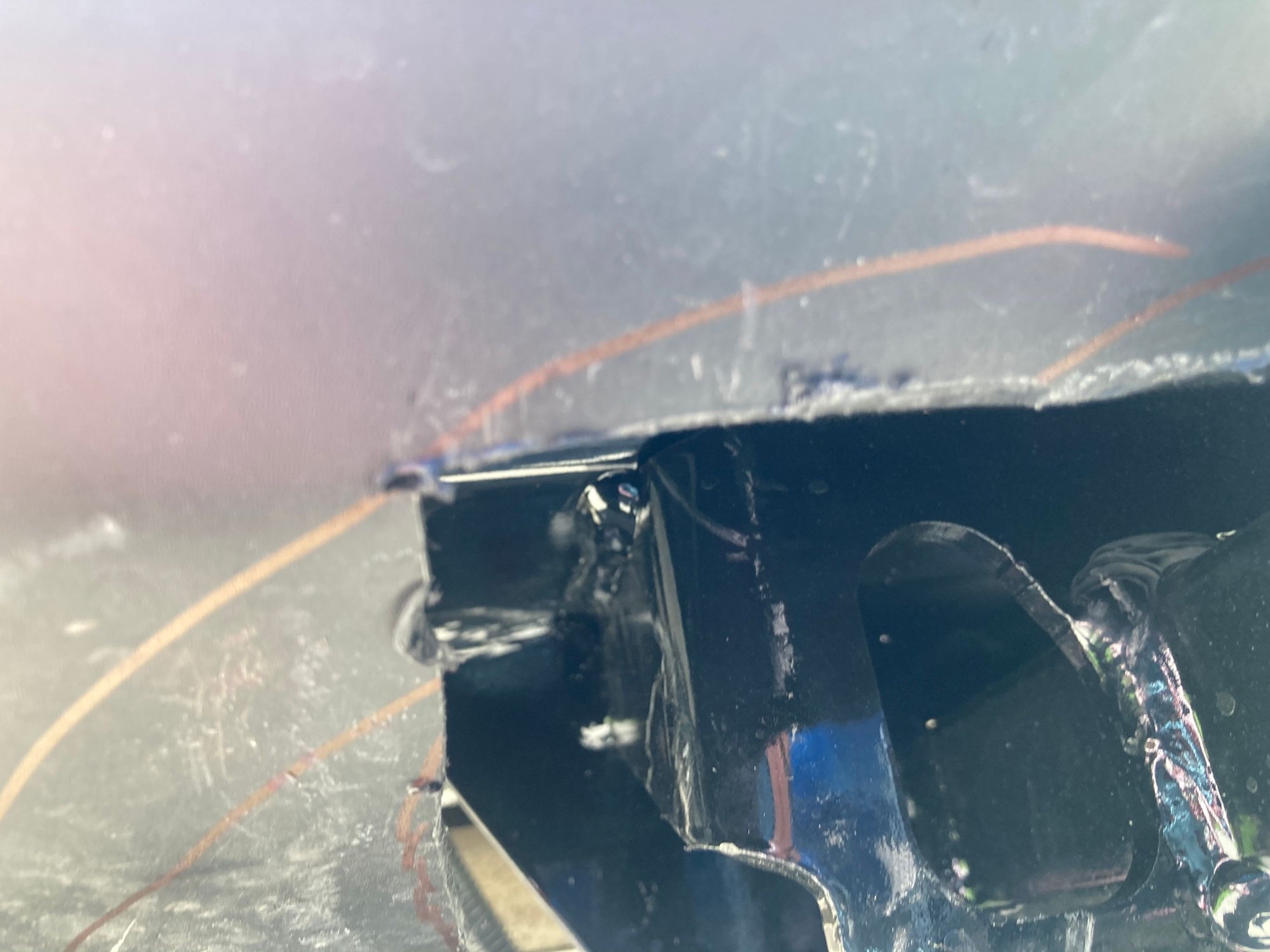

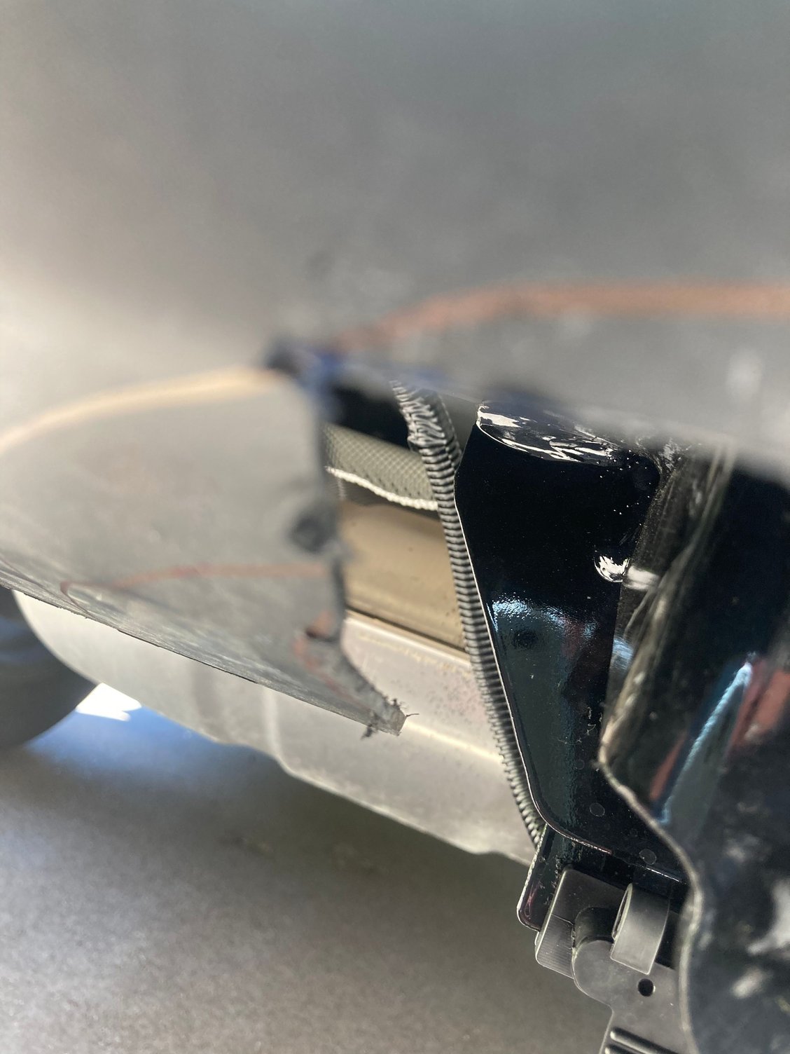

Hi all, I’m a newbie here. Just bought a new 2019 CX9 in February. Had a tow hitch installed at the dealer today and I want your opinions on if they did a bad job out if I’m just picky. Thanks in advance!

You should take it back. If that is a Mazda hitch, they come with a template for the panel and that cutout is not it. Not a professional job.

Its normal to cut out the bumper, but that is a very messy and unprofessional job. I personally would not be happy & would complain.
I would never let that vehicle leave my shop looking like that.

Poor cutting and lack of cleaning up said cut. Poor work, especially fora dealer. Looks like the car wash kid did it.

I would demand they correct that debacle, including replacing the bumper. I believe you have a good legal case, should they refuse to correct it.

Find an identical car with a neatly done job. Photograph it. Now you have ammo to say, "This is what I paid for, not what I got. Fix it." Don't waste time with a service writer. Talk to the service manager. If that doesn't work, go to the dealership's general manager.
And, it's partly on you. You should not have accepted the car back without a good look-over. You should have raised your complaint on the spot. Always inspect everything you paid them to do, even check the oil level after an oil change. You get what you inspect, not what you expect.
