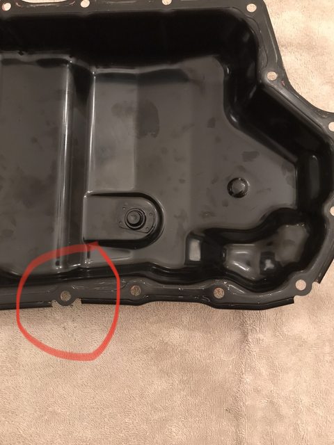

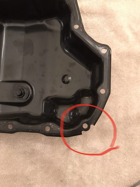

Also I checked with Parts warehouse and its the same listing no notation of different gasket?
2021 MAZDA CX-5 2.5L L4 Filter | RockAuto
The pan OEM parts number do not cross into most aftermarket pans? And the OE only has a generic picture of both those part numbers?
So for me without seeing a part number advisory from Mazda or physically looking at them I personally have no answer.

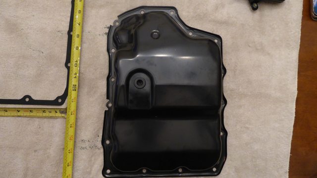

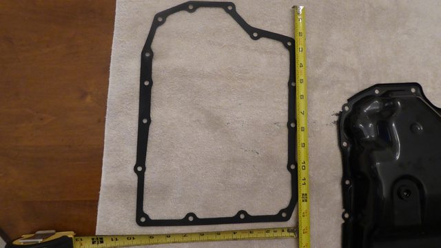

Oddly, Both these parts show as fitting my vehicle.
https://www.mazdapartsfactor.com/oem...pan-fzc12151xa
https://www.mazdapartsfactor.com/oem...pan-fz012151xb
I called wix cust service.
Rep said they had no knowledge of 2 different Mazda trans pans. requiring different gaskets, and that Wix WL10379 is all trhey have for my vehicle.
Also called Mazda Corporate in Irvine CA. Cust. Rep. took all my info. and concerns, but I know she did not have a clue about this issue and directed me to contact my locat Mazda dealer.
At this point , I bought a tube of Permatex Automatic Trans. gasket maker #81180 at Napa. Will seal it up and hope for no leaks. This is a new one for me so wish me luck.
Question: Is the Permatex #81180 suitable, or is there something better that you all know of ?

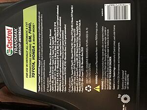

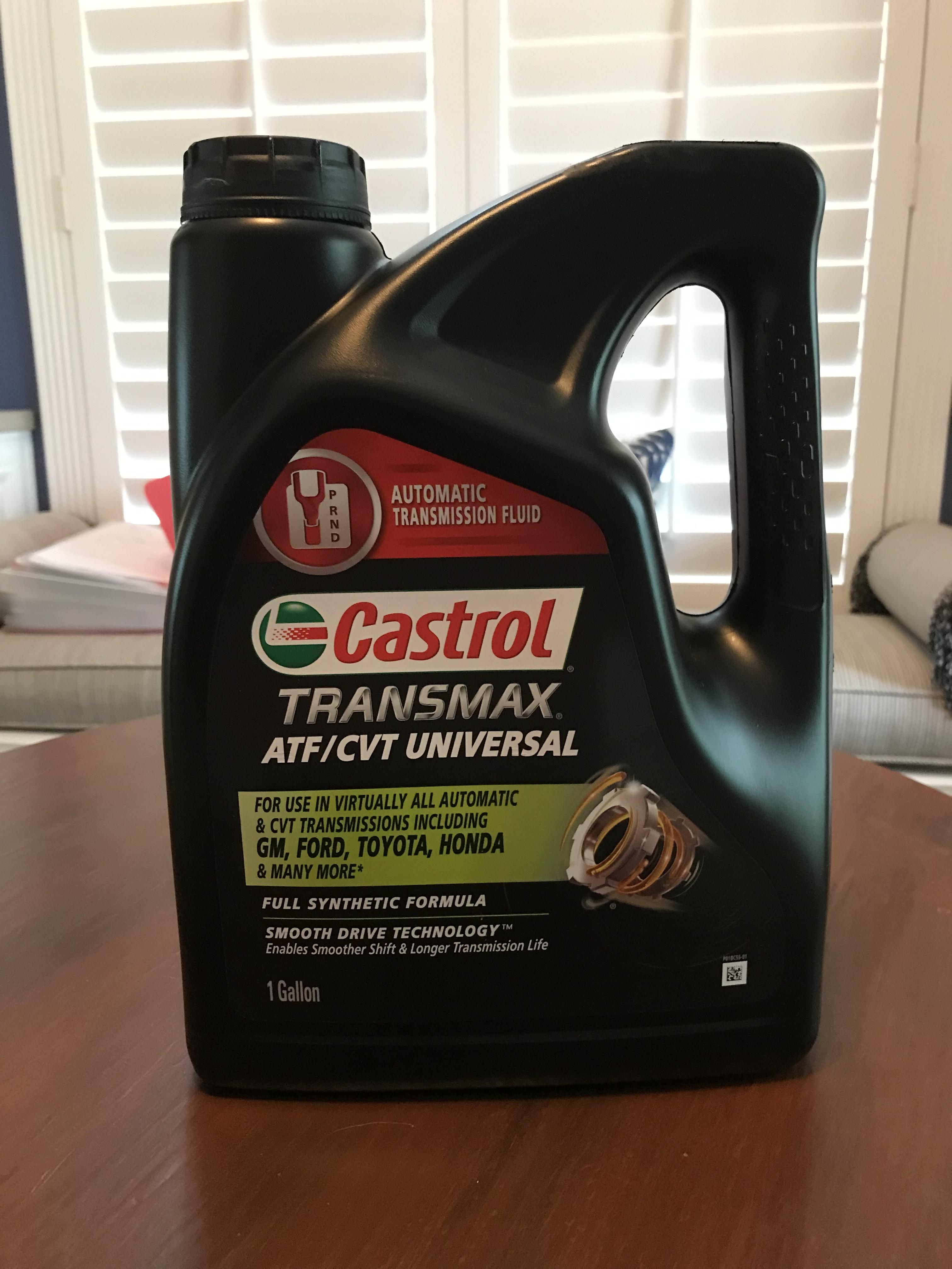

Is this the same Castrol Transmax that you use. The label looks different, however, ATF Applications show "Mazda ATF M-V, M-III, FZ"
Being that it indicates FZ, I would think it is compatable with Mazda FZ trans fluid. ? I just want to double ckeck before I put it in.
