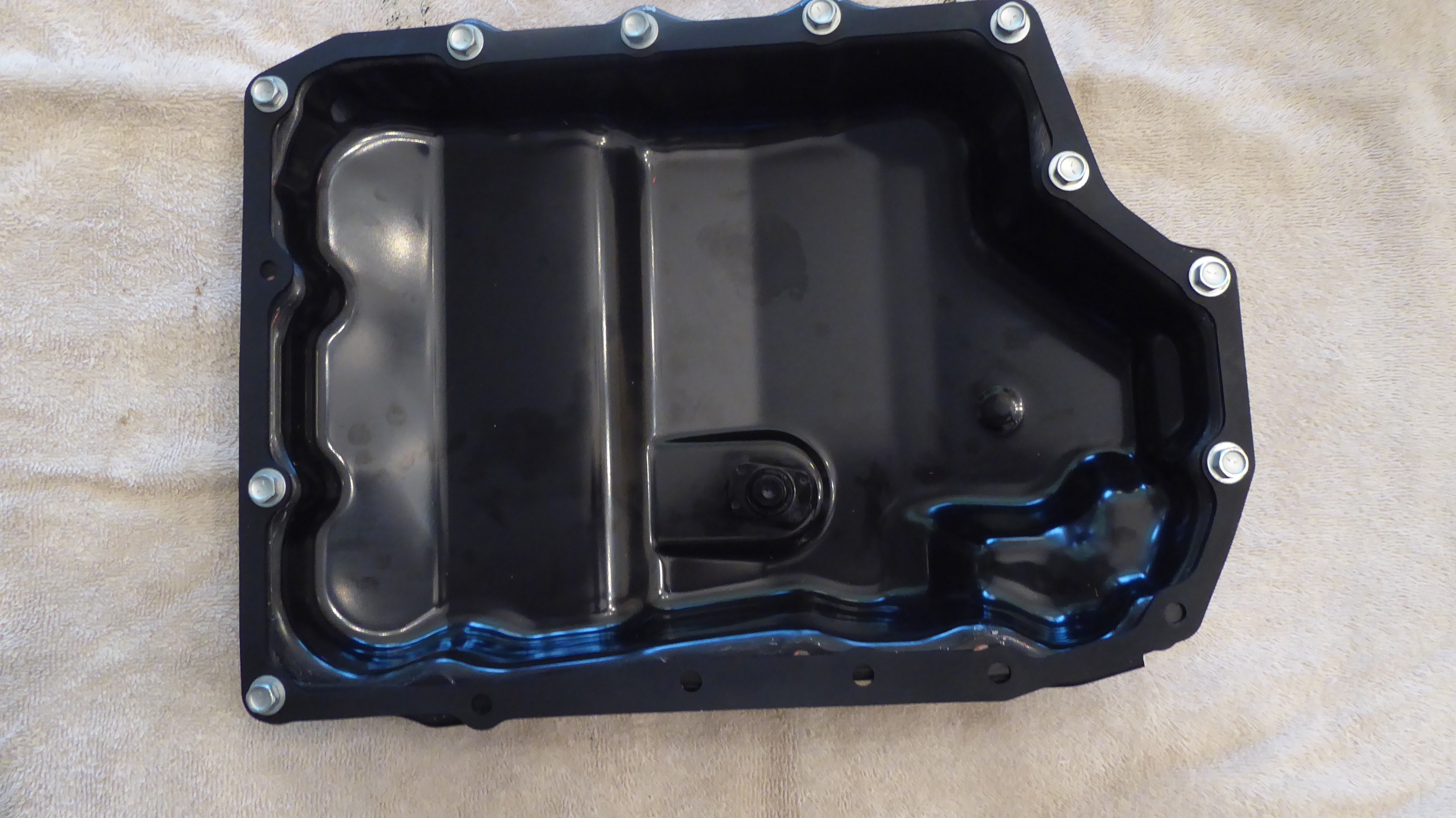

Posts: 10,665
This should be your pan and gaskit????

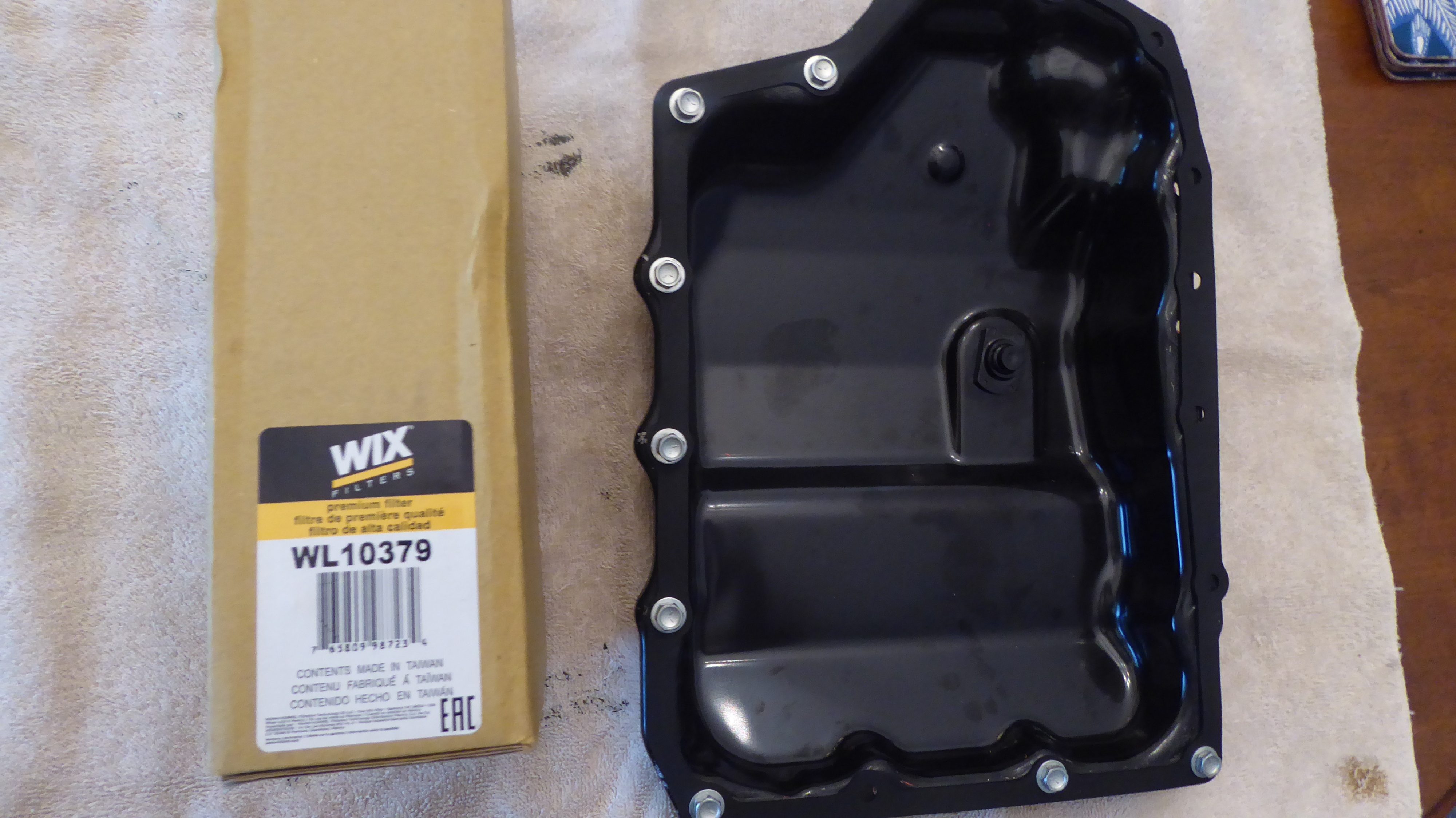

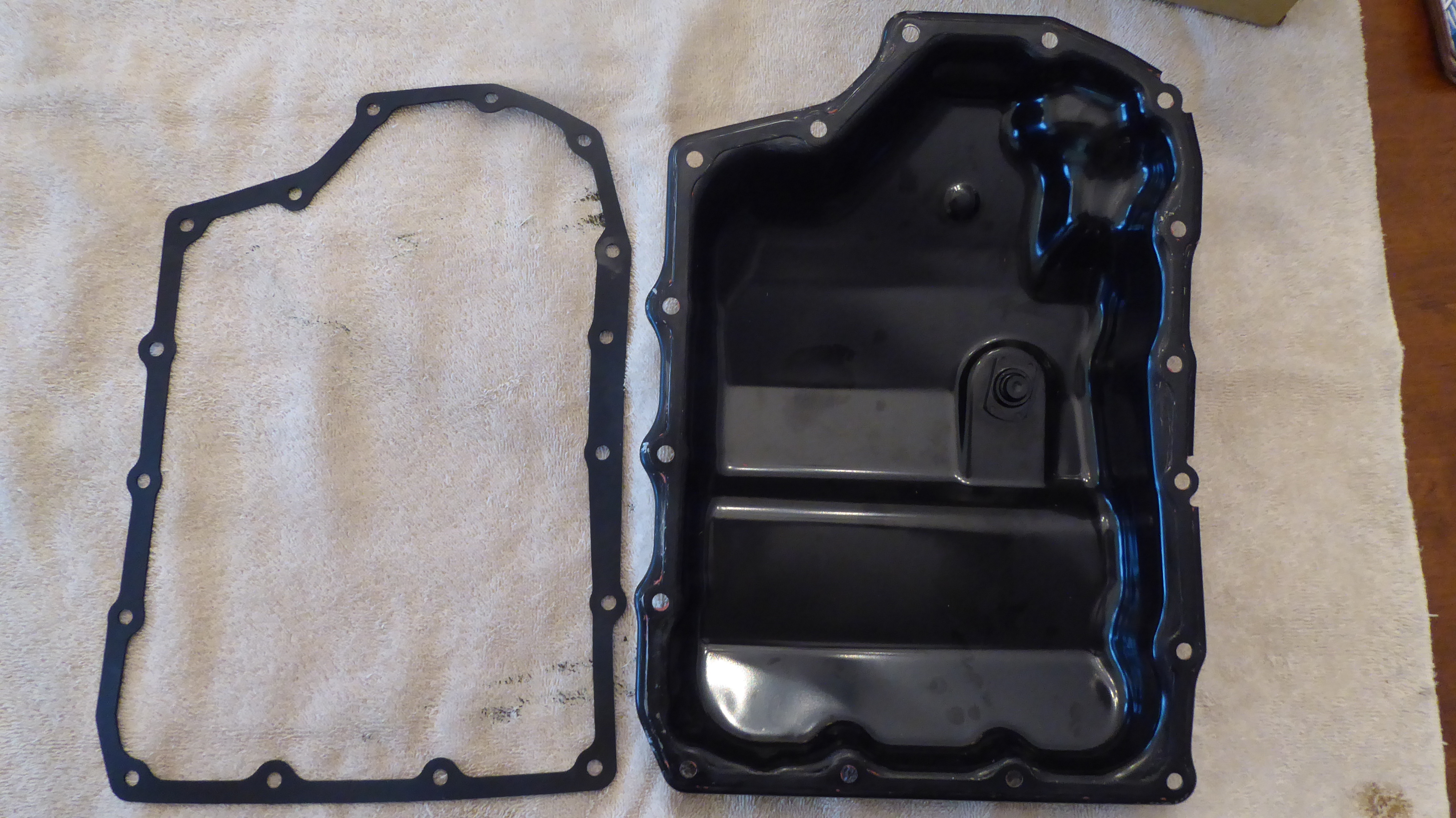

Default Pan & Gasket
Old Sep 26, 2023 | 05:48 PM
Posts: 10,665
what am I missing? it is the same as my picture both pan and gaskit?

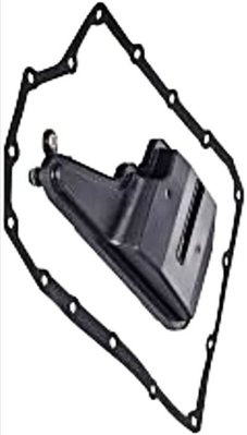

Its the right filter, gasket has 16 holes, but they don't line up on one side. Wix part number is correct, maybe a screw up when Wix guy in Taiwan packed box ?

This is a WIX ?
It fits my Mazda Pan
