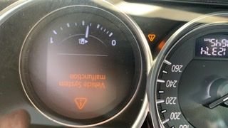

I am officially at my wits end 😢 I bought this pre-owned 2015 Mazda CX-5 2.2 Akera from a dealership 1.5 years ago and love, love, LOVE her! Didn’t have a days problem until February this year when I sent her in for her 90 000kms service. At the service they performed all the standard : oil and filter changes etc... + did a software upgrade because of a recall released.
Coincidentally, a few days later, after receiving the vehicle back, it came up with this Vehicle System Malfunction fault. I returned the car to the dealer workshop where initially I was told the software upgrade could have glitched so it was reinstalled and the fault cleared. 2nd time same thing. 3rd time I was told to replace a Vacuum Sensor, so I did and fault cleared. A few days later more lights then appeared and disappeared and I was told to replace the exhaust gas pressure sensor, which I did (diagnostics were run everytime I took the car back)... eventually I was told the fuel injectors could be faulty, not working or have a carbon build up and quoted an obscene amount of money to strip the car to check. Ontop of the already huge amount of money I’ve fished out!
I then took my car to 2 fuel injector specialists who ran diagnostics and said there was nothing wrong with my injectors. The second specialists took my car to electronic specialists who ran diagnostics and said the fault was on the camera and ABS modules and because these faults don’t ever affect the performance of my car- they suspected this fault was coming up due to the software upgrade done at the service with Mazda. (More money spent btw)
Off to Mazda I went again and the software spec level from factory has been reloaded on on my vehicle so the car has returned to the same level as before they did the recall software update.... (vehicle set back to “as built factory settings”). I collected my car exactly a week ago and this morning the f$@^%*g fault is back!!!!
Someone has to be able to figure this out. I have copies of all the diagnostics run, an oil analysis (stating fuel dilution) and pictures of all the dash faults and dates they came up - if anyone needs any more info.
PLEASE, there has got to be some genius out there that can solve my problem before I go bankrupt or loose my mind.
Fault codes... each time a diagnostic is run a new / different code comes up.
