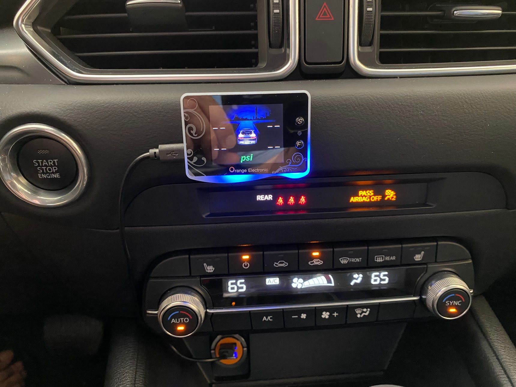

I finally found a GOOD solution to the missing individual tire pressure readouts. Still kind of irked to know the actual sensors in the wheels are the kind that read the actual pressure and don't rely on the ABS system and Mazda just couldn't be bothered to give us a screen where we can see the pressures.
AmazonSmile: Orange Electronic TPMS Mazda 2017,2018, 2019, 2020, 2021 CX-5; 2014,2015,2018,2019, 2020 CX-9 Tire Pressure by Location Display : Automotive - 100 bucks.
Enter the Orange Electronic TPMS monitor. This little device after a quick programming sesh will show you individual tire pressures from the OEM sensors. Just installed and programmed on my 22 Preferred. The picture shows no reading but it comes up pretty quick once you start driving. Programming is simple, deflate tires below 27psi in a certain order one right after the other. It has a mode for rotation as well so you don't have to relearn all 4. They cable they give you is LONG for wherever you want to put it, but I used a short microUSB cable I had laying around and mounted it where I can easily glance at it. Comes with velcro and the USB adapter.

I'd actually be interested in this if it didn't look like a kindergarten class crayon project.

Not a huge fan of the swirls myself. But it should be easy enough to make a sticker/label that overlays that part.
