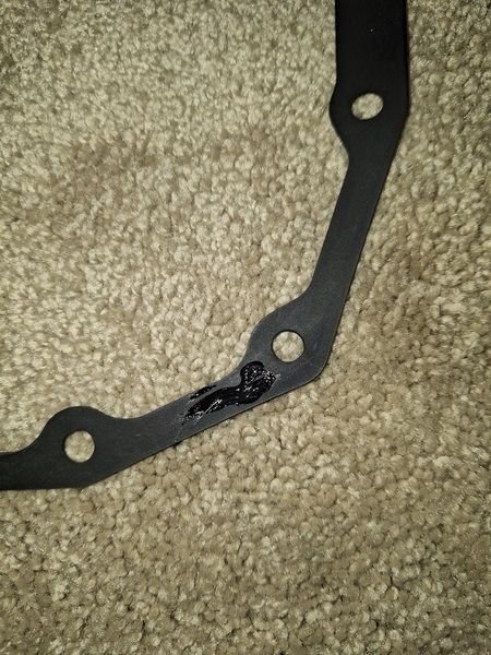

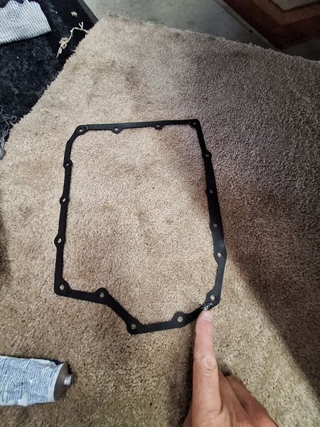

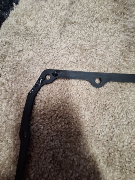

I did not use sealer except to hold the gasket. I placed a small smear on gasket/pan side only at 4-5 corners only enough to keep the gasket in position on the pan to place bolts back into the pan to secure the pan. I don't use sealer except in rare cases on any engine or transmission parts.
