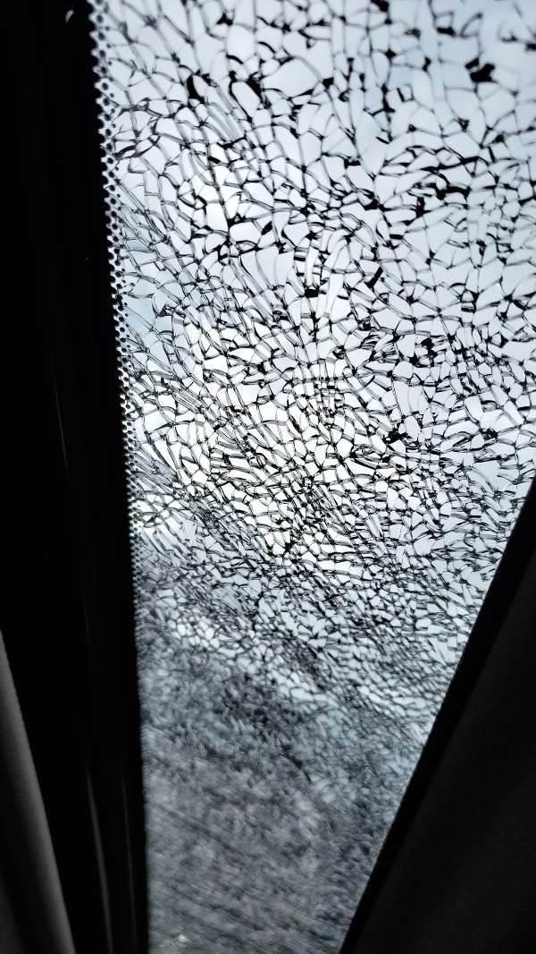

Default Sunroof exploded 6/16/21
Driving my 2019 CX5 today and I thought the same as the author… I thought my tire popped and pulled over to see that my sunroof had exploded outwardly.
Glad (?) to see I’m not the only one. Hopefully I can get reimbursed as well and will use this thread as proof that it’s happening to others.
The second image below shows how the glass is pushed outwards proving there was not impact from above. Plus I have a dash cam and there were no objects from a car in front.
