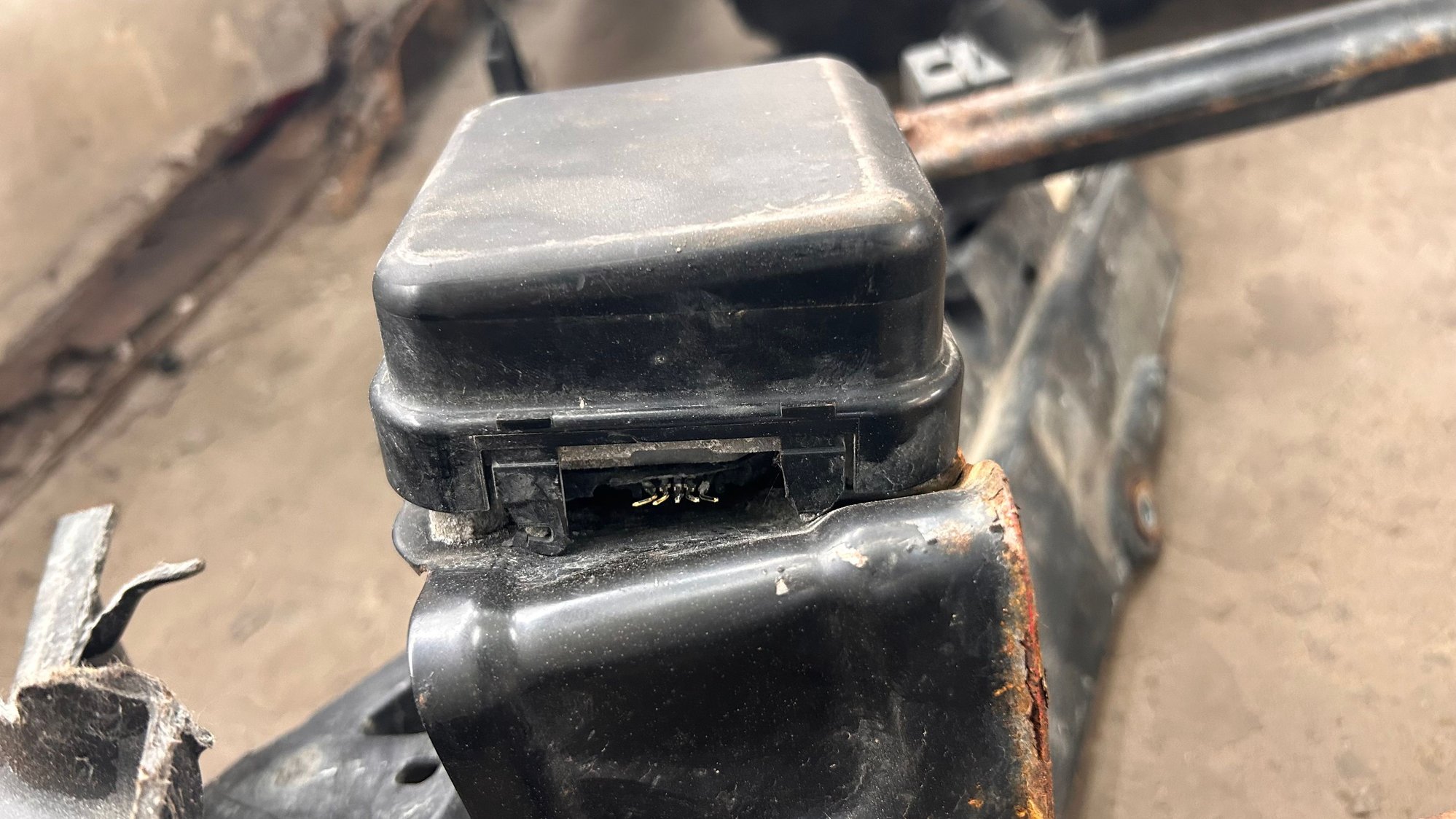

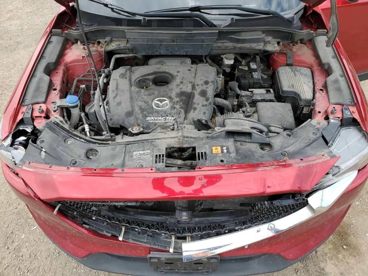

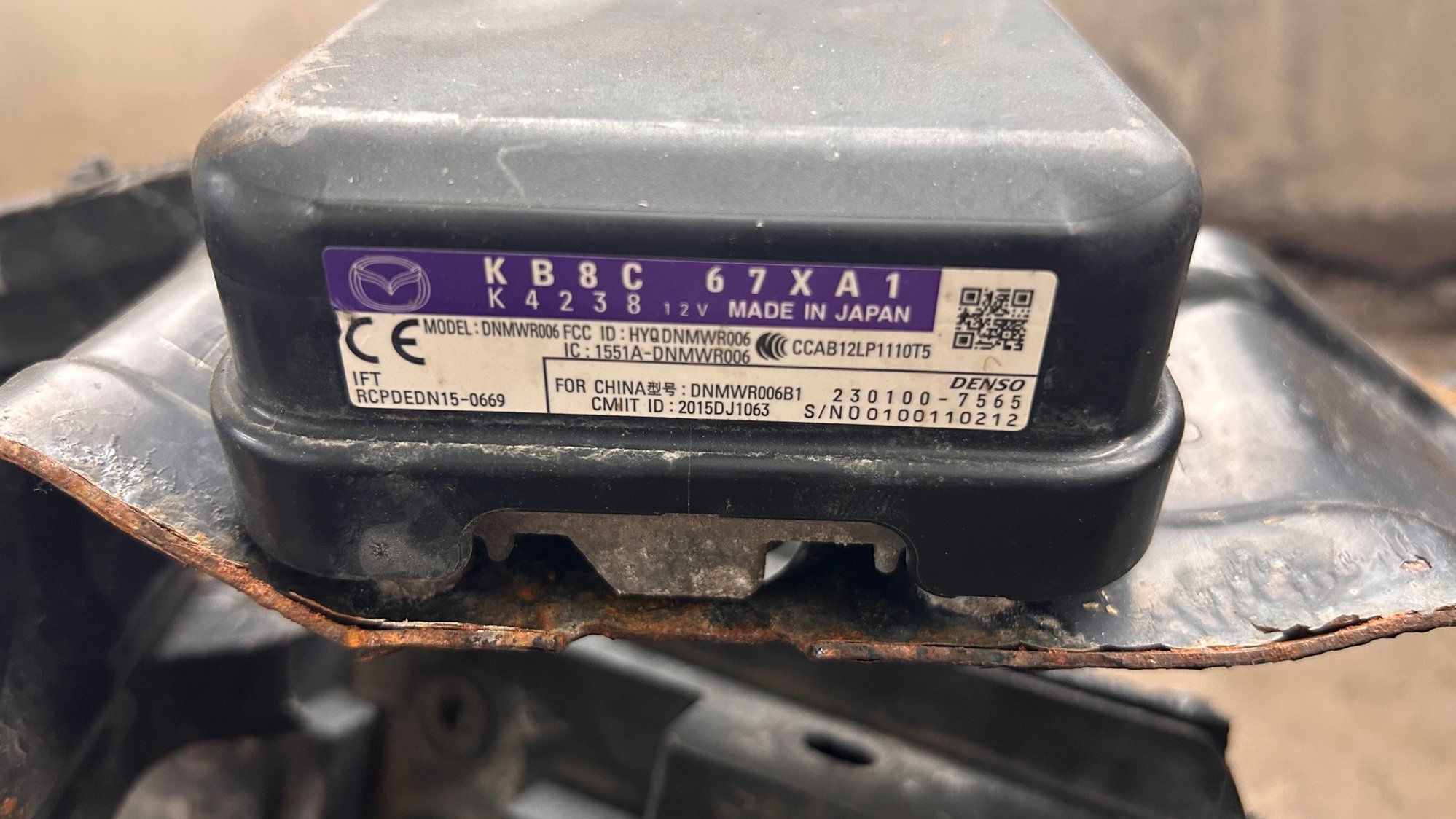

I Just bought a 2018 Mazda CX-5 Touring (SALVAGE) recently and currently it's getting fixed. My mechanic just noticed that the radar cruise sensor could be damaged, so I looked online for a replacement but they are extremely expensive and I'm not spending that much money on a salvage car! I took a few pictures of the sensor and I have a feeling it might be working still. as you can see in the photos the pins on the side are bent but could be adjusted maybe!! Also the cable or whatever part that connect to the pins might be missing, I have to go back to my mechanic and find out. Should I try to get it fixed at my mechanic shop or just take it to the dealership?

Welcome aboard.
You have no idea what you are getting when you purchase a "salvage" title.
These units are very sensitive and require the proper installation to work correctly which usually means an authorized Mazda tech/dealer.

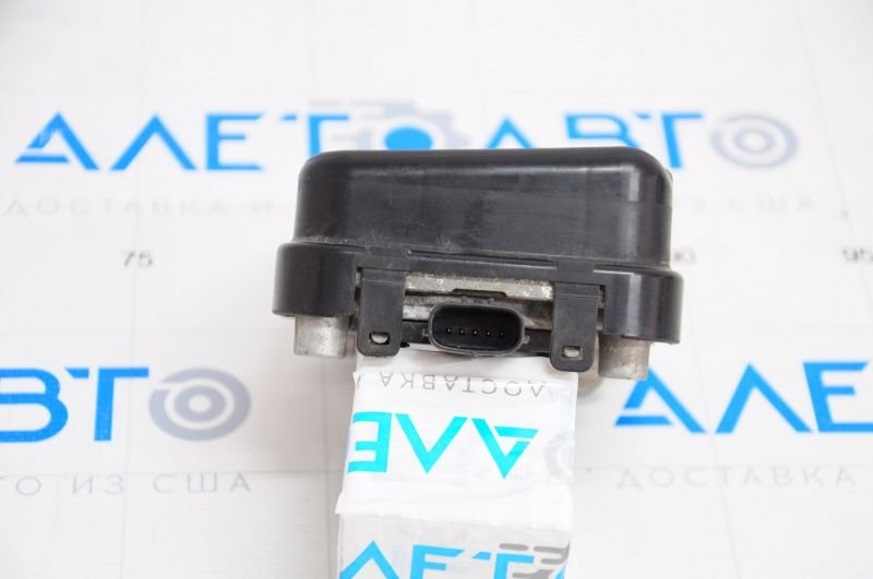

Not likely that unit is going to work as those pins are not made to be bent and then bent back into the correct position (see actual pin position and housing in pic below).
I can tell you something you won't want to hear, a new radar sensor alone is $1600 to $1800.

thats the car..

The mounting bracket will need replacing. The alignment of the radar is critical. Once replaced, the whole system will require calibration. Some shops deal with ADAS, otherwise a visit to Mazda will be needed.
