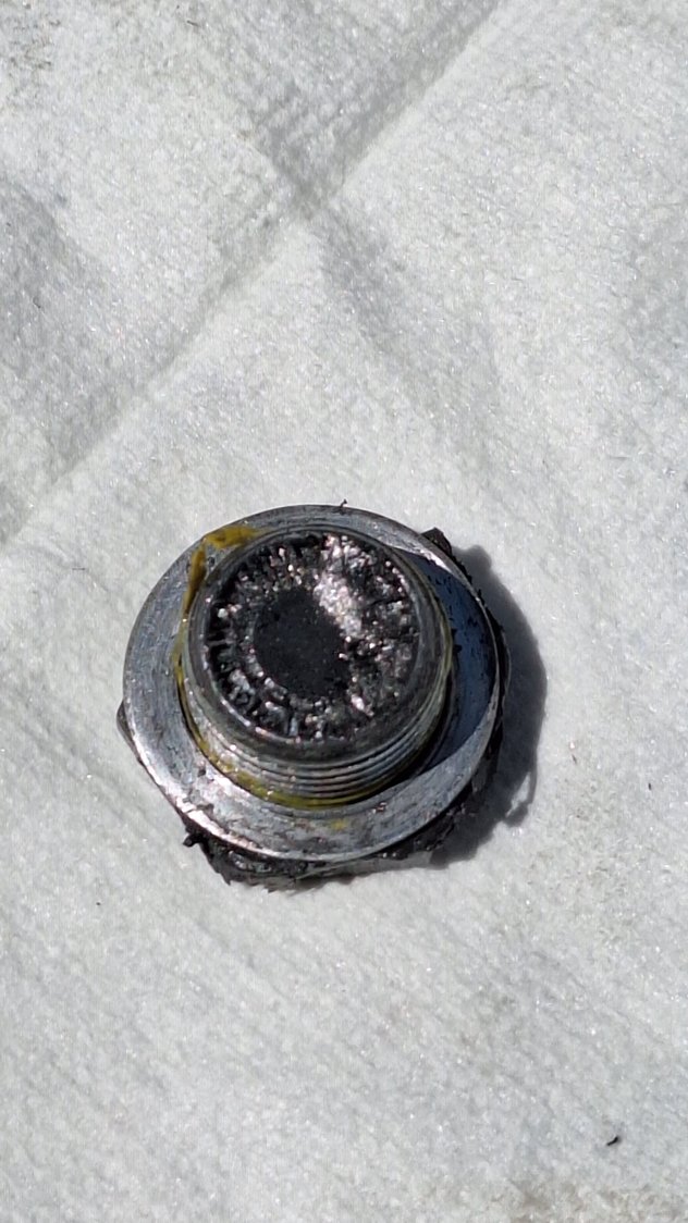

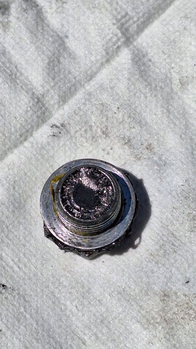

I detected a noise in my rear diff last week. 2021 CX-5 GT AWD, 124,000 miles. I had changed all fluids at purchase ~65k miles using Amsoil products. The car had been a rental before I bought it. After that first fluid change, I saw an oil residue on the housing on subsequent trips under the car for other tasks, so I checked it at every motor oil change just to be sure it wasn't running dry. I could not find a crack mentioned in another thread, nor any seepage from a seal. I cleaned and continued to monitor. I might have overfilled, resulting in some fluid coming out of the breather. Anyway, I did another change at 124k after hearing the noise and there were lots of shiny flakes on the magnet. Looks like a bearing is going. We have recently purchased a small camper (2,500 lbs) but have only pulled it maybe 200 miles so far. Otherwise, my tow bar has only been used for a bike rack. I don't typically engage the parking brake unless I park on an incline, which is infrequent.
