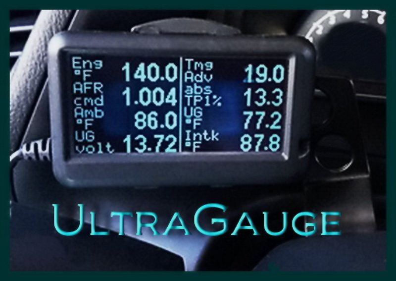

The OEM really is not a CAI that is a misconception. You really need to get out of the internet to find your information. The MAZDA Skyactiv air intake was designed to regulate the air temperature to improve emission and achieve the best MPG. This is not done by cooling the intake charge. If you were to actually monitor (I have) the IATs and compare most all so called CAI and the factory you would understand what I mean. Also would support that there is (Mazda skyactiv engine gas powered) not one CAI on the market that can achieve a cooler intake charge during city driving. The best can only come close to a OEM but the IAT will be slightly higher. Usually about 10-15 degrees of the ambient and more if AC is used or long periods of very low engine speeds and idling, like at stop signs. Frankly there is nothing truly gained from the aftermarket so called performance CAI except noise. The only true benefits over an oem are when engine speeds operated frequently at or near WOT and 95% or better Throttle position % on the drive by wire that is not re calibrate.
One of the many monitoring engine operations that I view daily is IATs (Intake Air Temperature) and fluid operating temperature's, oil transmission and engine oil also coolant. These all help me watch over my engine as well give me vital information about what goes on with a 2.5 Mazda Skyactiv N/A engine.
