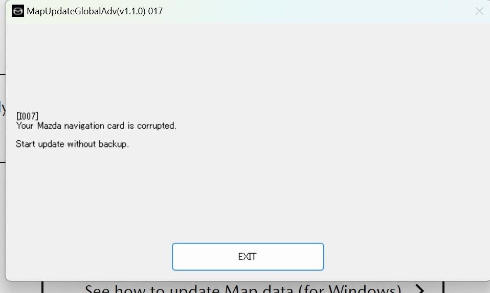

The plot thickens; it seems you need to discard MAZDA TOOLBOX s/ware, if you have latest SATNAV [11" Screen], and
only use MAZDA UPDATE TOOLBOX.
LINK;
How to use Map Update Global Windows (Mazda Update Toolbox) - Navi World
Inserting my MAP SD yet again in my Windows 11 laptop, opening Update Toolbox, I'm now seeing slow progress,
but card is being updated with the March updates

Your photo of the SD card shows almost the same label as mine. My code number is "KAAA 66 EZ1", without your trailing "A".
Therefore, it makes sense to update this map with Mazda Update Toolbox (the latest Toolbox version), as I mentioned three times in my replies to your question:
"Did you download and install the toolbox from https://mazda.update-mapnavi.com/?"
Glad it all worked out!
Please note that it may take many hours for the update to complete.
BTW: your account name "Geluk" means Happiness in Dutch!

..after 4 hours of updating, got a failure message at end
In dealer's Service Bay tomorrow.

No "geluk" then :-(
You wrote before: "Windows, when it sees CARD, says it needs to be "SCANNED/ FIXED""
If it is already corrupted, give it a try to repair with Windows and perform the update again without making a backup.
