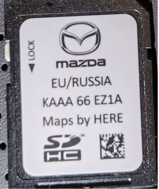

I've got a 3 week old CX5 and tried to update car's SD Card, via my PC.
MAZDA TOOLBOX refuses to see SD on either a WINDOWS 10 OR 11 PC.
Very frustrating; problem seems commonplace.

  • Did you download and install the toolbox from https://mazda.update-mapnavi.com/?
  • Is the SD card a genuine Mazda Navigation SD card or from Amazon?
  • Is the number (for example KMV6 66EZ1) on the SD card the same as one of the numbers on the website?

  • Does the navigation works in the car?
  • Have you driven the car far enough (100 km or 60 miles) to link the Nav SD card to the car's VIN number?

  • You have the same SD card number as I have in the Netherlands.
  • You have driven the car far enough.
  • The card is not "locked".
  • You are using the new Mazda Toolbox as downloaded from https://mazda.update-mapnavi.com/

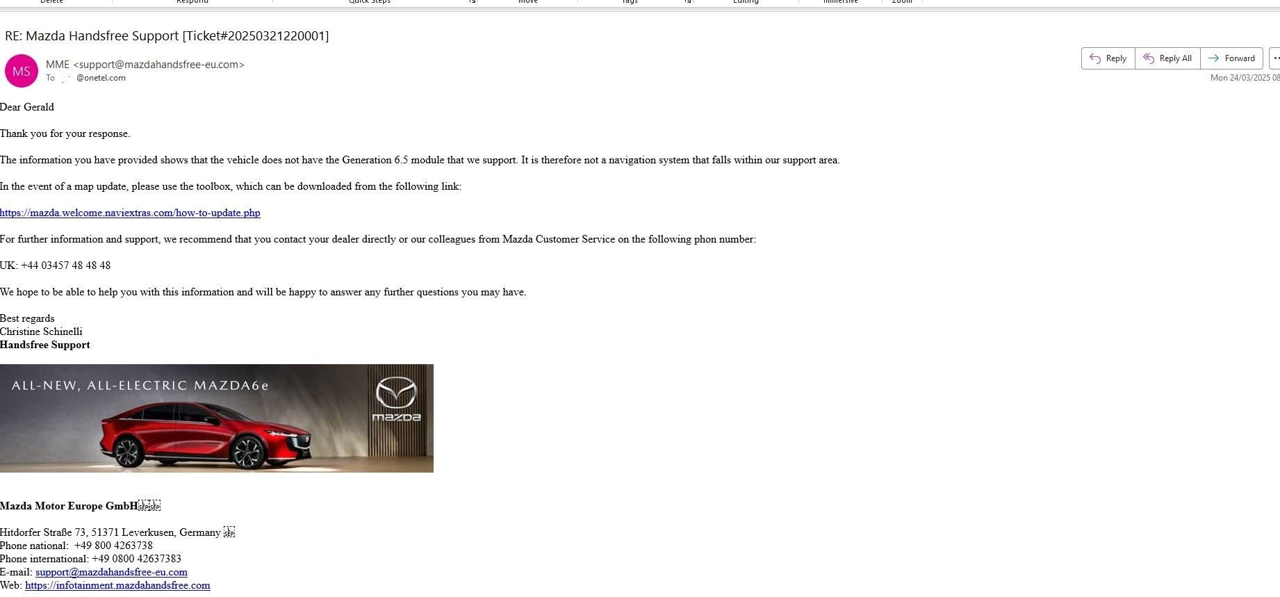

I also reached out to MAZDA HANDS FREE SUPPORT; staggered at response.
I have the 11" screen incidentally.
