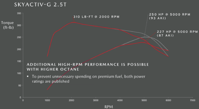

Sorry I got it wrong! With your foot mashed to the floor, the Turbo shifts at about 5,200 rpm, and redline is about 900 higher. The only way to get there, however, is to put it in Sport mode and slide the shifter into manual mode and upshift at the rev limiter, which is just silly because in the last 900 rpms the engine is dropping in horsepower dramatically, sucking wind, and it sounds sad. Check this out:
You can see the point of dropoff in the torque and horsepower numbers happening at about the same location on the chart with either low or high octane fuel. I guess the point I'm trying to make is that letting the computer do the shifting for you is best. After the 5,200 rpms it just sounds awful and feels anemic. But WOW is that low-end torque fun! It really pulls you around town quite effortlessly. And the way the gears (only 6) and final drive ratio multiply the torque, you leave people from stoplights and shock the hell out of them. It's a sleeper racer.
And yes, the turbo stays on boil throughout an acceleration run. Every shift just pulls with a fervor! It reminds me of the 1986 Mazda 626 GT Turbo I had when I was 22 years old. That car was a blast! The CX-5 tickles your youngster funny bone when you have the windows open and can hear the turbo's wastegate make that pssshhh sound when you jump off the throttle after a dash of acceleration. One thing that's a bummer is that the computer is quick to shift into second gear as you round a corner after a stop sign. I'm not a kid anymore so I'm no longer stomping on the gas pulling around a corner (ok, from a stop that is) as I'm not trying to make the tires squeal (which it will!). But, once around the corner if you need to hustle, stomping on the accelerator slams the transmission from 2 to 1 resulting in a neck snap. Hooliganism.
So no need to worry about your T numbers! Leave your endocrinologist behind and enjoy the logic Mazda's engineers put into the smooth transmission which shifts well before the redline yet still puts a smile on your face as you haul a$$ and blow people's doors off.

DYNO testing is not done in the fashion of "mashing" the throttle to the floor. In fact, DYNO testing a Skyactiv model MAZDA is a bit challenging for the DYNO operator and also setting up the program and DELTAs for a run. I might also add that not one of my colleagues across the USA doing DYNO testing in their shops specifically having performed DYNO runs on MAZDA Skyactiv power train models has been able to duplicate what is "published" about their stock factory claimed output.
Having DYNO'd several model Skyactiv model Mazda's and now at an experienced plus 30 runs I can say there is a bit of fudging advertising regarding MAZDA. But then they also do not comply and participate with the standard industry Certification of engine power and torque to SAE J1349 or SAE J1995.
If you feel that what I posted is not accurate, please provide the following:
The name of the shop performing an independent DYNO run
The Delta used that day of the run and the follow up DELTA adjustments for additional runs same day
The DYNO result before any SAE smoothing
The DYNO result after SAE smoothing
Listing of any engine modification from a stock platform.
Fuel used, name of supplier and octane rating
The we can discuss somewhat on the same frame of reference information about DYNO results having to do with MAZDA Skyactiv engines!
