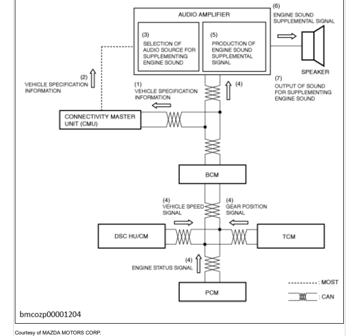

Originally Posted by climbinglife
Dealer said it was normal
Are you sure this whine sound isn't coming from speakers? Recently Mazda has been adding artificial engine sound in their turbo cars, maybe CX5 got it now with type B infotainment.
Record sound with your phone right on top of speakers and move it away. Fake sound is generated directly in audio amplifier and by design cannot be controlled from volume control and keeps working even when infotainment system is off.

I was unaware of this but mine isn't a turbo.
Wow! Any way to defeat that. I removed the ISE (induction sound enhancer) from my MX5, but it was mechanical.
