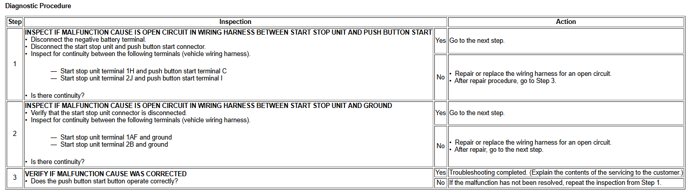

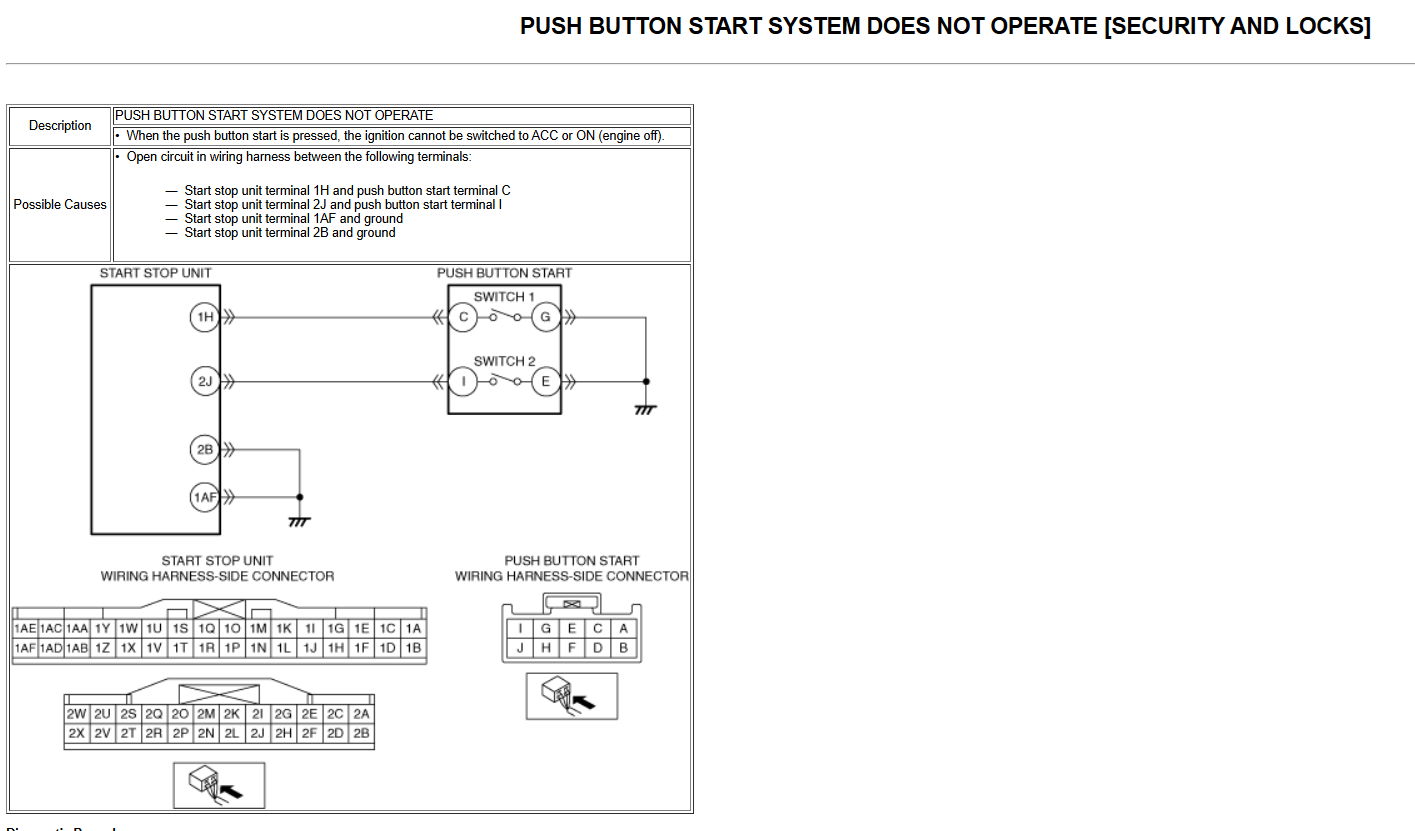

As per your description, I understand that:When the push button start is pressed, the ignition cannot be switched to ACC or ON (engine off).
You can view the repair guide on the website: https://mazdamanuals.com/ choose CX-5 2019 ==> Body and accessories ==> SYMPTOM TROUBLESHOOTING [SECURITY AND LOCKS]
Thank you to everyone who replied. I’ve read in several places that the battery could be the source of the issue, so I will give it a try and update you on whether it was helpful. In the meantime, if anyone has any other suggestions, please share. Regarding the diagram you sent, raothuong, I will do my best to understand it, but from first look it looks something very close to what you shared.
